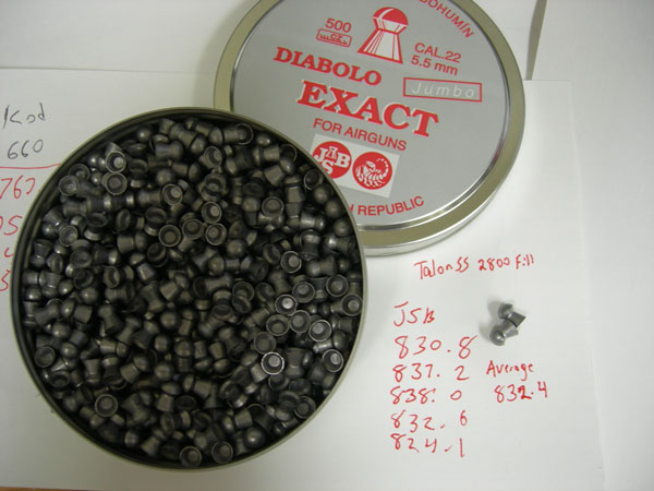

.22 JSB Exact
I thought CP’s were cool, until the price went up. I finally ordered some JSB’s to test in my talon SS (with std. 12″ )
I shot them in the house at paper and they did well. Today I quickly ran 5 over the chrony after a 2800 fill. (outside)
830.8
837.2
838.0
832.6
824.1
average = 832.4
😮 I didn’t think my stock TSS would move a 16gr. pellet that fast!
At $12.99 for 500, If they are fairly accurate I will have a new pellet.
I added the numbers to chairgun2 and it looks like it will be great pellet choice, and it will extend my range a bit over the 14.5 CP’s
I was reading somewhere where someone said that the lead is softer in the JSB’s than the CP’s.
Does anyone know if this is true?
If it is the case, then the JSB’s might expand better, transfer more energy, and create a slightly larger wound channel?
Thoughts?
Roger
