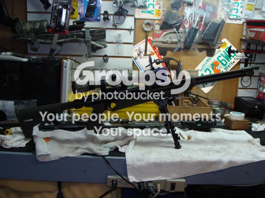

I miss this carbine that I built. I modified a custom GTBJ condor forearm and used a disco tube with a LW .25 barrel. It was shooting 40 fpe and it was one hole accurate at 25 yards all day. Never should have sold this one!
Looks Great a real sharpshooter.
Deutsch,
That thing looks cool. Kind of like hpa 22xx version of the Accuracy international stock 😎
