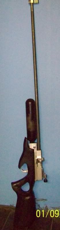

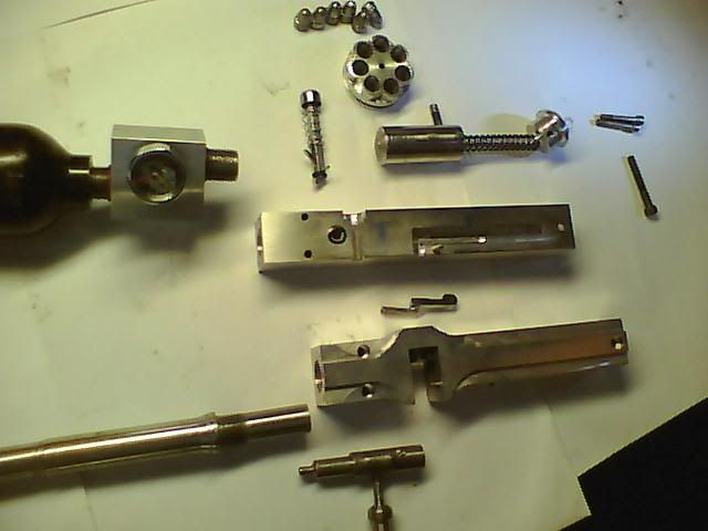

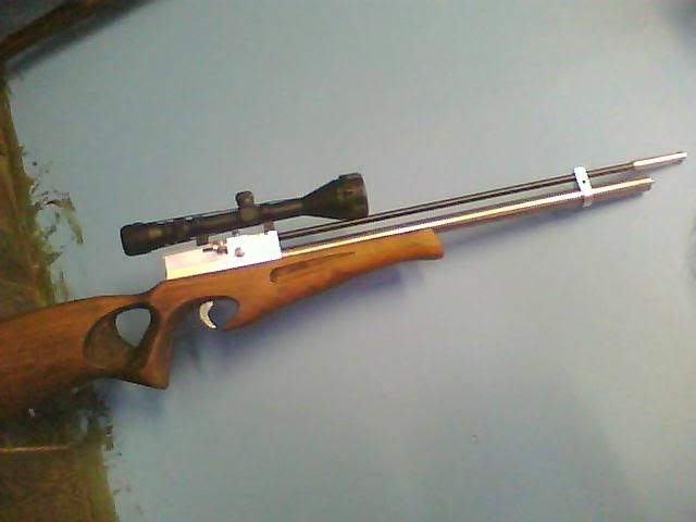

a lil project,, almost finished
i was doing alot of condor ish guns , decided to change it up an build 2 repeater , a 9mm an a .22
the 9mm started with a 17” barrel , not long enough … so i made a 34” .
havent tested them alot but enough to know they are working well an hitting centerd at 100m. still tweeking the power .
pictures are poor . sorry

the barrel is rifled , 6 shallow grooves , just button rifling for me , but it works well . in the video you can see 2 little dark spots under the milk jug , so its hitting well at ( i think ) 110m+
im not sure what the 9mm is shooting for speed , with the 17” barrel it was 680f/s ish with a 124gr . an low psi 2000ish . with the long barrel its way faster , id think about 900 f/s , i did put a heavier spring in to .
but i want enough shot out of a fill to for 14 good shots an 14 ok ones .
it holds 7 in the cylinder , an loads easy .
the .22 is a 9 shot , shooting 940-950f/s w/14.3gr for alot of shot , varing only about 5f/s in 10 shots . air tube is about 10 cubic inch .runs on 2200psi well . ( SOON the 100m test )
