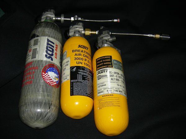

I had to invest in some fittings. but now

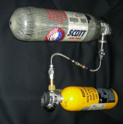

If I cascade the two smaller tanks, meaning I use the lowest pressure tank to fill the talon tank to as high as the lowest tank can fill it.
Then move the fill adaptor to the full tank to top off the talon tank.
I should be able to get a few more fills than each one on it’s own could achieve by it’s self. (I hope)

Special thanks to William AKA wvanryper for helping me figure this out:
On this post:
http://talonairgun.com/forum/viewtopic.php?t=1391&highlight=

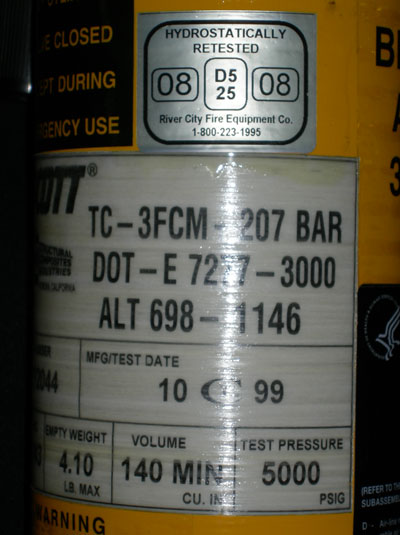

3000 psi = 16.8 cu ft
3200 psi = 17.9 cu ft

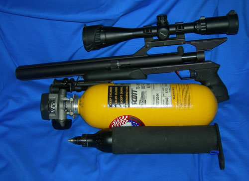

Now I can easily fill my SS in the field when hunting.
One or both will easily fit in my packpack, and if I cascade the tanks I should get quite a few 2800 psi fills.
Now if I donโ€™t have anything to hunt I can quietly plink to my hearts content with out fear of running out of air.
