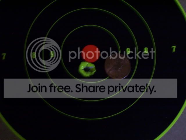

18.1 JSB at 1024 =42 ftlbs—–yes ideed the M.O for the shroud is out tomorrow…—–scope set to 50ft—held over exactly two dots –target at 42ft—– 😯 —-I will for sure be turning this beast back down—-sure the velocity rolled off pretty fast from the 3100 psi in the tube– going to get a full fill on the tank tomorrow 3400 and will shoot 20 with the adjuster backed out…hoping for a shallow curve———There is a single pellet laying in the hole that 5 jsbs made at 42 feet–after the scope was mounted on the gun there were no click adjustments made where the first shot landed is where the group went…the firing behavior is real neutral -feels good….I like this gun…————————–and yes right now — its politely —LOUD LIKE —REAL F_CKING LOUD… 😆 😀

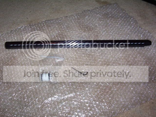

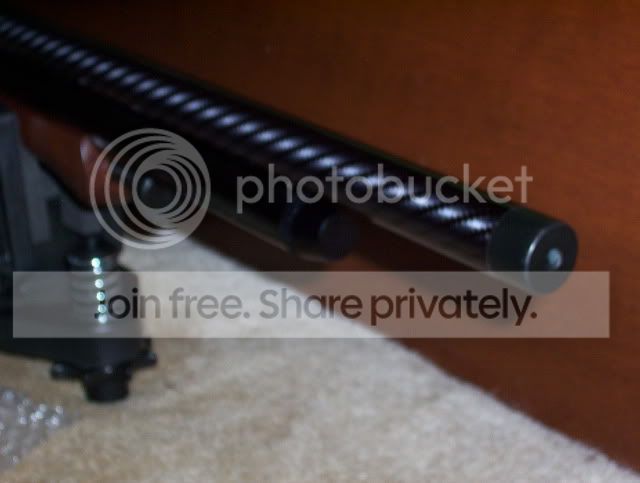

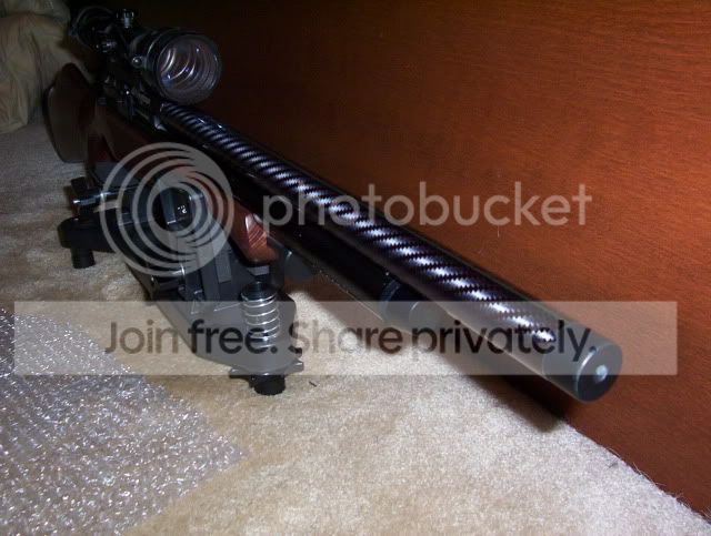

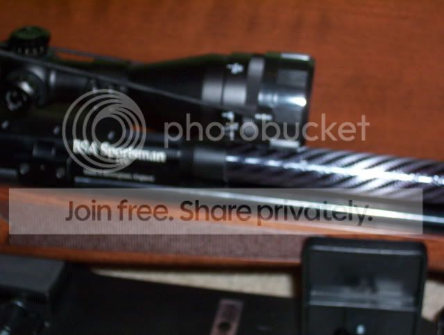

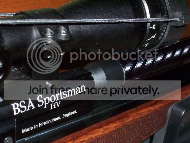

The long LDC and De-pinger are here…. —the beast is now tame…Mounted everything up -removed cylinder and inserted depinger—filled to 3400psi —ccocked gun (no pellet) –pulled trigger –sounds just like an old low powered multipump 760… crisp pop!—wanna check the alignment before I send a pellet tru it…..—Rich in Mich hooked it-up! Was expecting a flat black LDC but he sent a COOL looking carbon fiber-look accented LDC. fit is to the T…..May be slightly more quiet than my DONGed 18″ .20cal SS…….Very satisfied customer….Will post some more updates as I go…..Gotta go look at a car real quick and earn skriller for AIRGUN habbit……

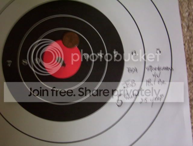

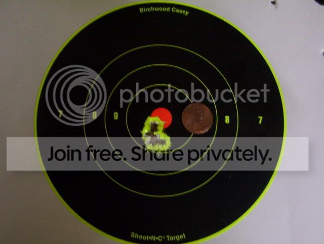

Just too loud for the house – packed it all up and headed over to Nicks Gun and Tackle (formerly Eds Gun and Tackle)–and indoor range –Scuba shop was nice enough to give me a High fill-3900 psi to be exact…— Didnt bring the chrony with me to the range — just wanted to see what it would do at the range–25 yards off a bench in my site vise……. Very – Very Accurate

Just too loud for the house – packed it all up and headed over to Nicks Gun and Tackle (formerly Eds Gun and Tackle)–and indoor range –Scuba shop was nice enough to give me a High fill-3900 psi to be exact…— Didnt bring the chrony with me to the range — just wanted to see what it would do at the range–25 yards off a bench in my site vise……. Very – Very Accurate….[/img]
[/img]——the top and very bottom bulls are 5 shots each — the middle bull is 20 shots….—I should have the shroud by some time next week— will post lots more goups then —Very easy to shoot well– Very accurate – very well built – power house.
Man that looks great..Those 18.1gr’s are flyin….Especially with that fill
psi…..I had the screw backed out enough so that the cap would just
barely go back on….I think you will find a very nice bell curve when you
get the fill to 3,400psi…That shroud will make it plenty quiet enough to
shoot in the house too….With the clip holding 10 shots it is not worth the
power reduction to try to get more than 20 full power shots…It will be
shooting too weak trying to get 30..I think 20 is a perfect # for that gun
and that is were mine shot the tightest groups…..

Nice group….What did the chrony #’s look like…? Bet is was loud in the house….
