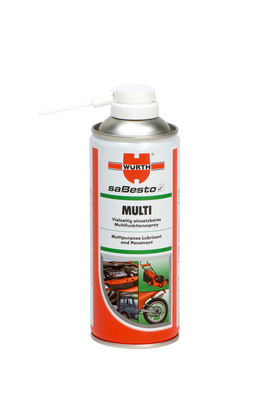

CNCricket did you relube inside mechanism of cricket with oil or some grease? I´m asking due to when I strip my HW100 and all degreased with break cleaner and then I applied Wurt Multi oil. I have good experience whit it. HW100 have more stable consistency (warm-cold)
