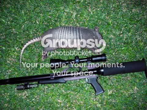

Good suggestions here. Forget a laser. The red dot disappears on dark fur at any distance. For low light, I use a Zeiss Scope, but they are way pricey. A light mounted on your gun will do just fine. I have a Sure Fire C-2 on mine, but will be switch out to a OLight M-2 Warrior soon. It will give great run time with up to 225 lumen’s.
You don’t have to use an expensive mount. A simple 1″ scope mount made for our rails works just fine.
A few night varmints.
