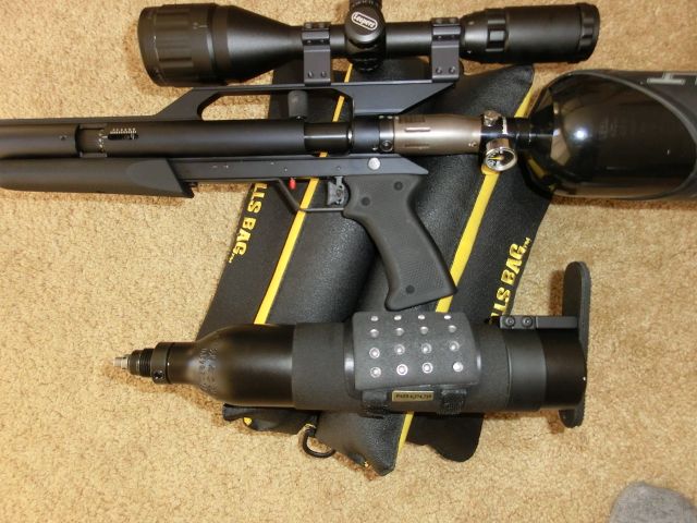

I just picked up an E-TaCREG + JDSAirman Reg + 48 cu in tank + Wokbutt setup off of the Yellow and boy is this thing fun to shoot. I probably shot 1000 rounds through it so far (.177 and .25) and the ES/SD is really really nice.
It developed a slow leak at the set screw so I was bummed. Searched the forums and found a thread, emailed Dyotat100 and he helped me out with the info I needed.
Basically replaced the two o-rings (008 & 013) on the stem with the shims inside the ETaCREG with 90 Dura Viton ones. Put on some Pure Silicone Grease (Trident) and put her back together. Filled her up and so far (30 minutes) no leaks.

is it to close scope? can you see the scope comfortable?
the setup comes with the vale? I see you have spare tank with valve on it.
