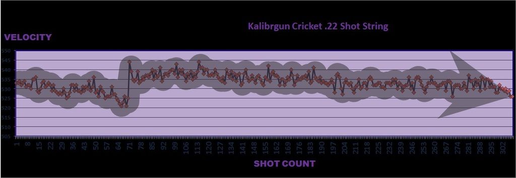

I turned down the power further on my Cricket to 10 FPE and did some chrono work today to check the results of my regulator and hammer spring setting shooting JSB 16-grainers. I don’t know what the regulator BAR setting is set to as I don’t have a reg-tester. Anyway, the starting fill pressure was 210 BAR. The pressure after the last shot was 165 BAR. I stopped on shot number 70 because I ran out of pellets. ๐ฅ I wanted to see if there was going to be any reg-creep after letting my Cricket sit overnight; when the gun was set to 12 FPE the first shot would be around 30-40 FPS higher than the average if I let the gun sit overnight. I attribute it to incorrect HST setting. It looks like at the current setting, I am not getting too much creep (or maybe none at all judging by the string). At any rate, I’ll continue where I left off on the chrono work once I’ve restocked on pellets to see how many more shots I can get while maintaining a 15 FPS extreme spread. Anyway, here’s the data plotted on an Excel spreadsheet I created. What do you guys think?
