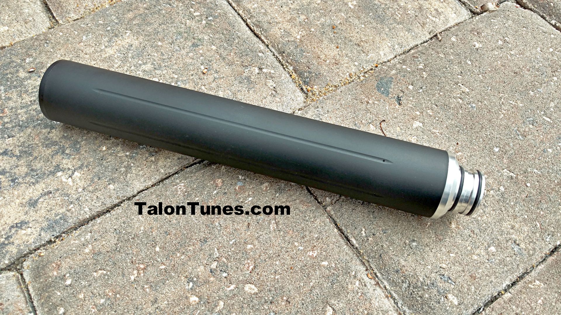

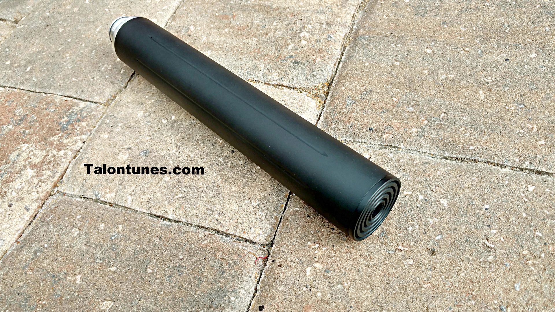

Gen.6 SOS Sound Moderator 9″
Our sixth generation of TalonTunes sound moderator SOS.
Shroud/Sound Moderator 9″
All anodized finish. No scratching or chipping.
360 degrees of venting.
Custom made high efficiency internals.

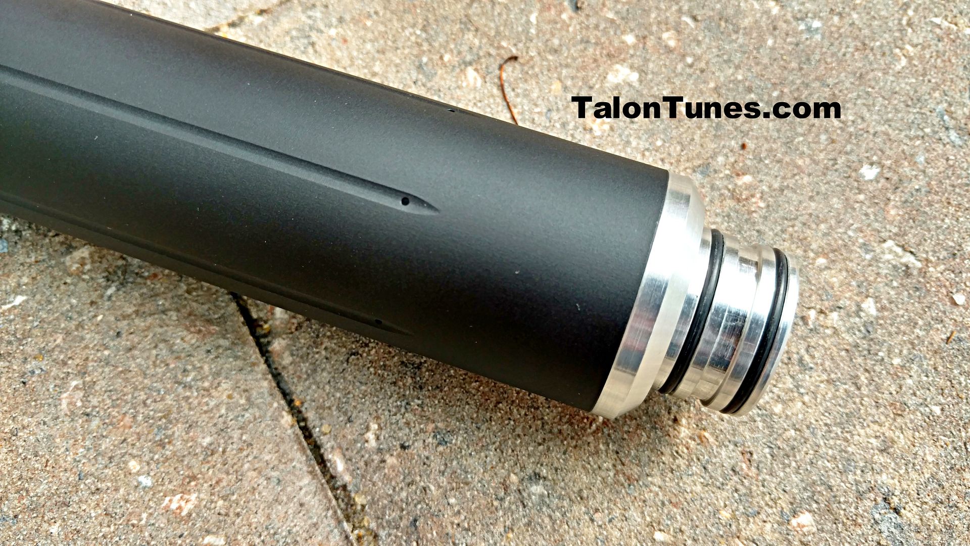

Double o rings on connector.
Designed to replace your factory end cap and secures with included custom set screw.
Will work with or without sound lock system.
Will reduce sound signature by 60-70%.
Will work with .177, .20, .22, and .25 caliber.
Can be installed in seconds on…

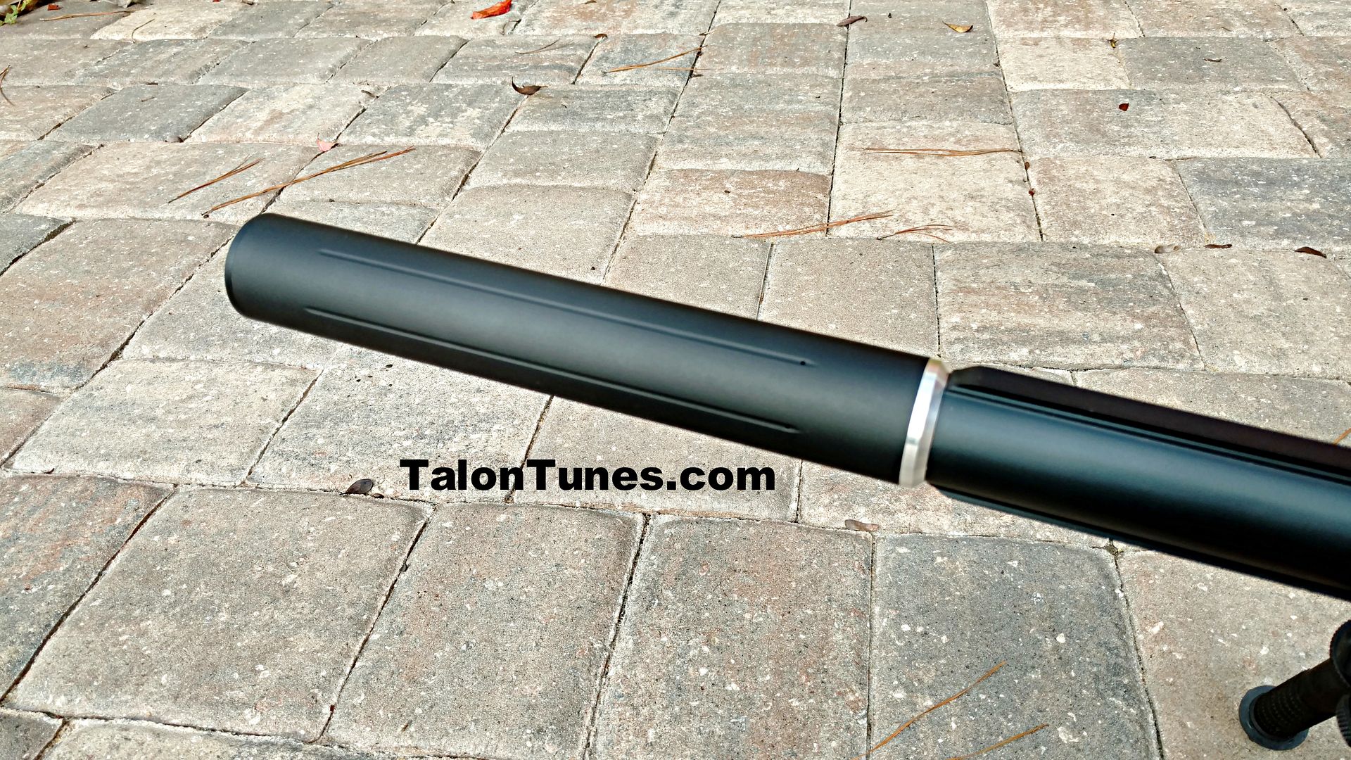

I have the 24 in barrel on my condor and there is 6.5 inches going into the shroud. I would imagine the shroud would still work. Are you running a condor ss? My shroud is 14 inches total. I threw in a vented barrel bushing today and ran some more shots threw it. I dropped about another 1.5 db is all. At 40 fpe the shot itself is 88 db and the impact is 114 db. So the impact is alot louder than the shot now. Bone stock no shroud it is running 123-125 db with the same setup. The gen 6 shroud dropped me almost 40 db which is a ton. Somebody clapping is more noticable than my gun now.
I have also run about 25 shots through it at 3400 psi with no issues. Accuracy is top notch and im blowing through 1/8 thick steel pans at 30 yds and the gun is still very quiet. 110 db. At that pressure with no shroud its over 130 db and the meter will not pick it up.

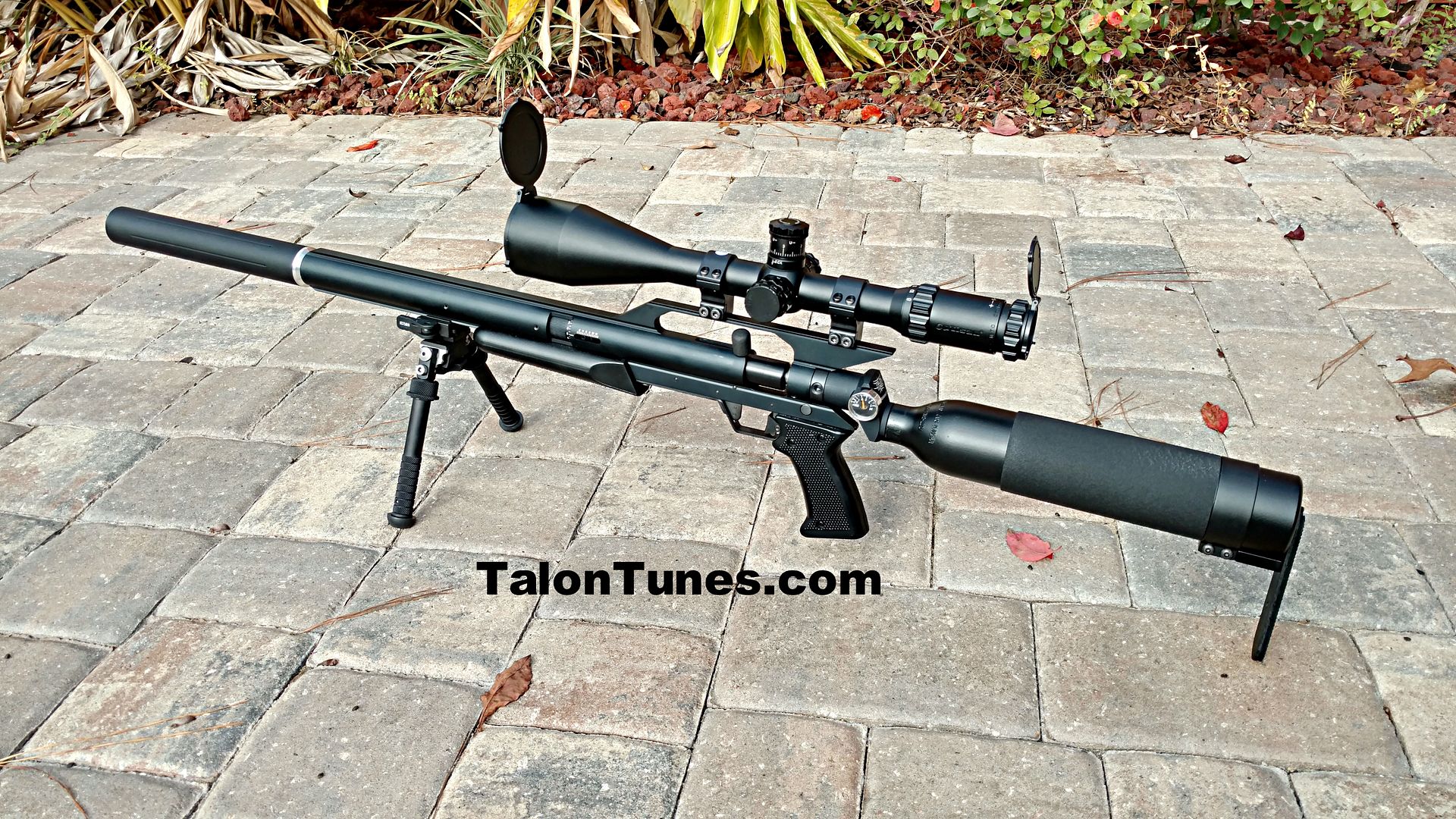

This tt shroud is impressive and all the proof is in my videos. Well worth the investment. Attached is a pick of my setup ready for the yotes. Sits at the foot of my bed in front of the fireplace so as soon as i hear those turds i can pop up and out the back door.
