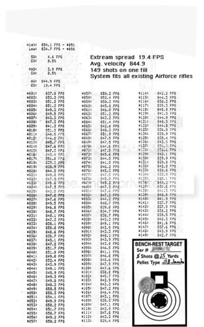

Benefits of a regulated airgun include: increased shot count and consistent shot to shot velocity (standard deviation (S.D. around 5). The E-TaCREG provides the comfort and ergonomic benefits of the E-TaC’s cast-off and drop. The regulator has a built-in tank pressure gauge and male foster nipple for quick-fill convenience.

Shoot over the chrony and see what velocity they start to bunch up at, and then let me help you find the psi that will match that velocity.
Jim
