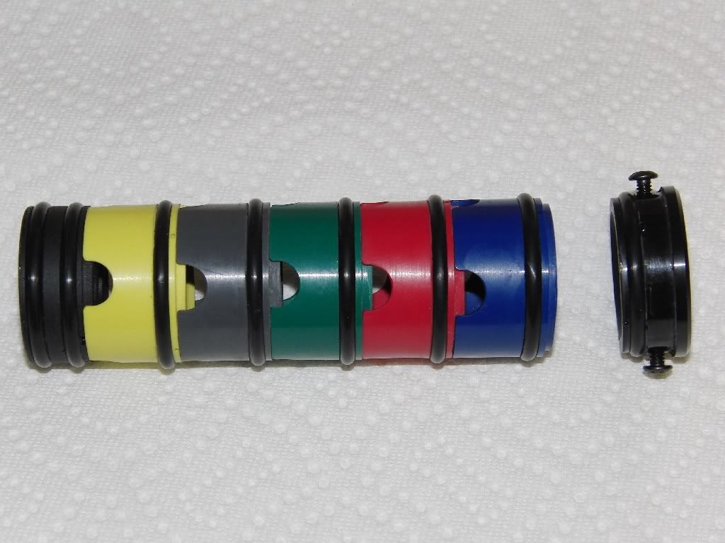

STORY: When i got my Disco .22, i turned it into a CROSMODS DISCO .22. I kept the stock 24″ barrel on it. I tuned the CM.22 to shoot 18 gr JSB’s at 880 FPS. Then, once i field tested it, i found it liked the 15.9 gr JSB’s a little more. So then i tuned the gun to shoot the EXACTS at the same 880 FPS. Now, after numerous folks have talked me into adding the BAFFLES (LOL), i decided to chop off 4″ of the 24″ barrel to fit the baffles into the shroud. After lobbing off 4″ of barrel and putting the gun back together, i’ve found that the gun still shoots the same 880 FPS as before i chopped off the 4″.
So what gives? Can any of you make sense of this as i thought adding or removing 1″ of barrel equated to 15 FPS. So 4″ should have resulted in my gun shooting the Exacts at 820’ish FPS not the same 880 FPS. But believe me……..I’M NOT DISAPPOINTED AT ALL…LOL. Just curious. I also checked the gun with the 18 gr JSB’s and they were also traveling roughly the same as before the “SNIP”.

Just curious as poi has been known to vary on some rifles with/without shroud…I wonder if their is any variation in fps. Also, I wonder if the shroud helps minimize the “wasted air” detriment that can occur on shorter barrels with hopped up valves… ❓

There is a lot of merit to that and is a component of the full tuning of an airgun that is sometimes overlooked. We all talk about hammer weight, hammer spring, valve stem spring, pressure and volume, but barrel length does play a part in the equation as well. Ideally, when tuning a gun, you want to minimize air blast after the pellet has left the barrel, which is why a well tuned gun will be substantially quieter than a non tuned gun…all things considered.

Tofaz… as always… great work and great pics to accompany.
