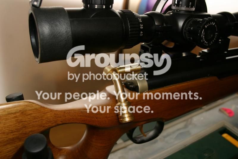

Here is a pic of one I found. It looks like it may be resting on the stock…obviously you would not want a brass finish on a tactical look…

Joe,
I am going to do that. I ordered a recoil pad from Brownells, and while cruising their site I saw they have bolt handles for sale that might work on this rifle also.
I am considering buying a bolt handle to replace that pull handle on the action, that would make it look really nice and be easier to manilpulate.
