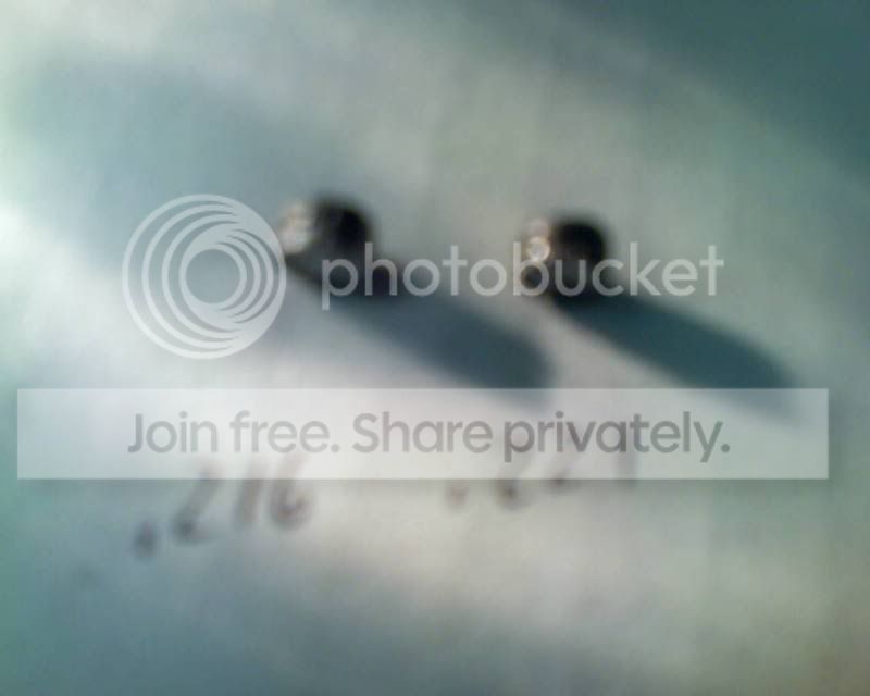

Measured the actual amount of choke in my SS
I measured the choke in my talon .22 barrel.. .0035 smaller in the choked end. I had read on here in another post (that I cant find now) there were about a half thousand of choke..which may be true for some barrels but not in my barrel..its impossible to measure with dial calipers due to the rifling, I tried it at first just for the heck of it..I did find that non of the riflings are the same depth though..one was about 11-12 thou. deeper than any of the others..
