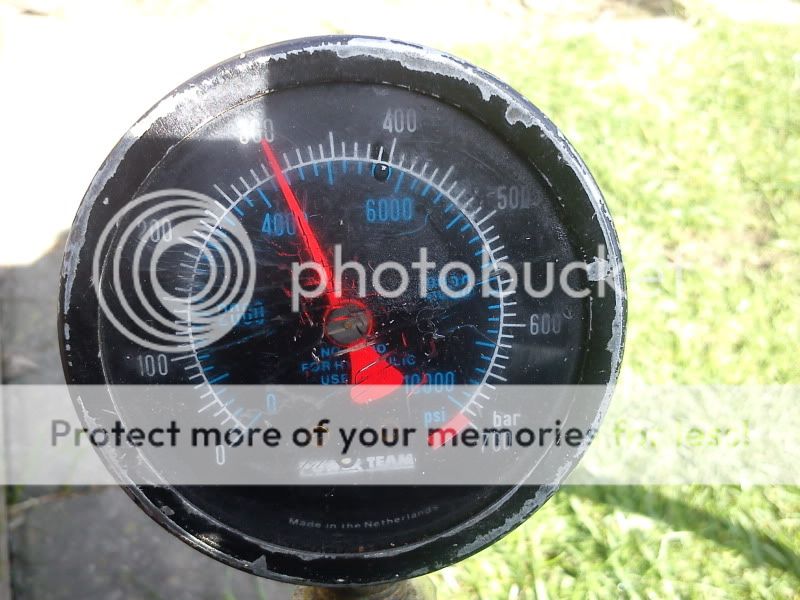

with the valve i have coming i should be able to shoot the 7 rings at that speed and possibly the 9 rings but it will take me some time im sure it can be done im looking into a 4500psi pb tank and some other parts that should get the 9 rings at over 1000fps i will keep u updated

i will give u a complete list of what u need as soon as my .25 condor gets here i think i have all the parts to get them to almost 1000fps i will let u know were to get them from and there price
Are you saying, your .25 cal can shoot Jerry slugs 9-ring to 1000 fps?
