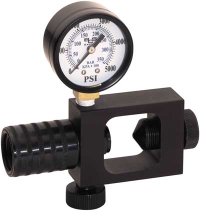

Thanks Cygnus – I already have the doohicky above – but I was under the impression that a DIN to K Valve wouldn’t work on a tank with pressures of 4350psi. If it does, then I’m in good shape as I can get a DIN to K-Vavle adapter locally.
The K valve setup is not rated for the working pressure, but as we control fill via the tank valve and don’t fill over 3k, the K valve adapter is fine, as it will never see the full 4350 psi, only the pressure you fill your tank to. just go slow with your fills (which you should do anyway)
airghog will sell a DIN fill kit, just tell them for what rifle, and what parts you allready have
you can also get a DIN to k-valve adaptor and then you can use the doohicky in the picture above
