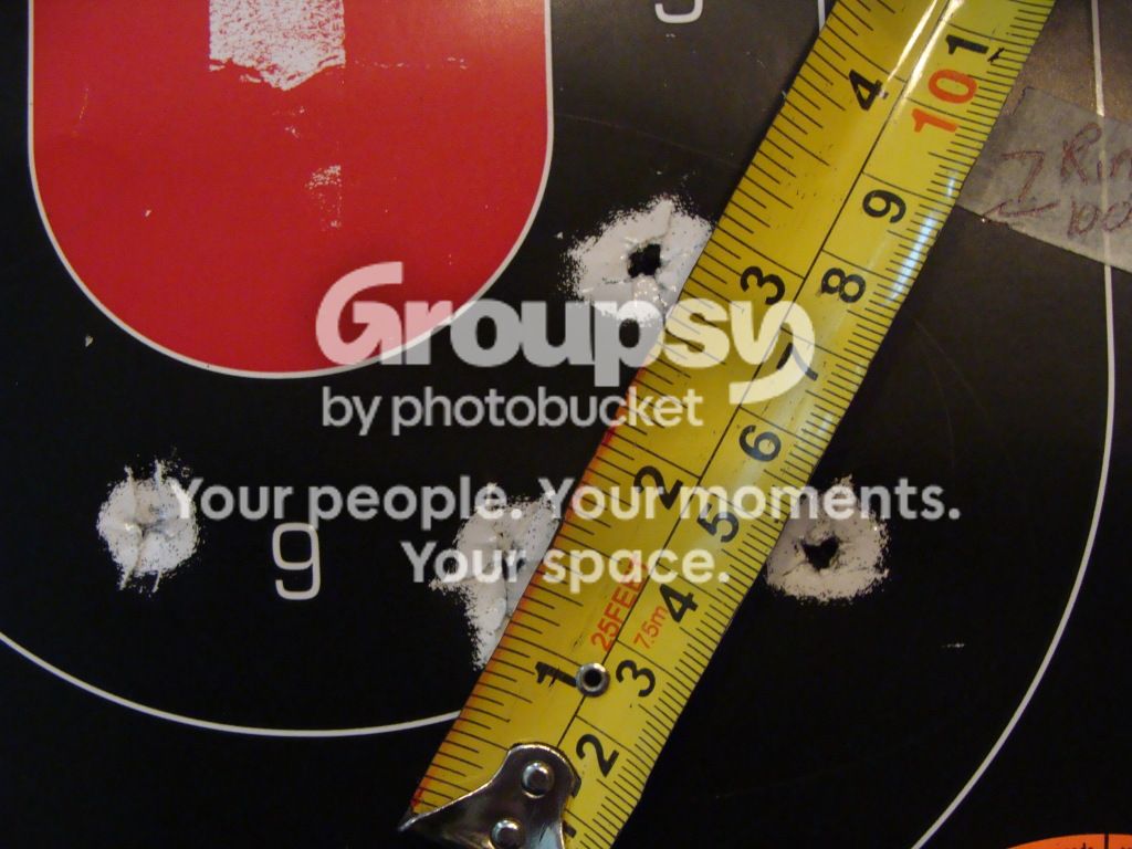

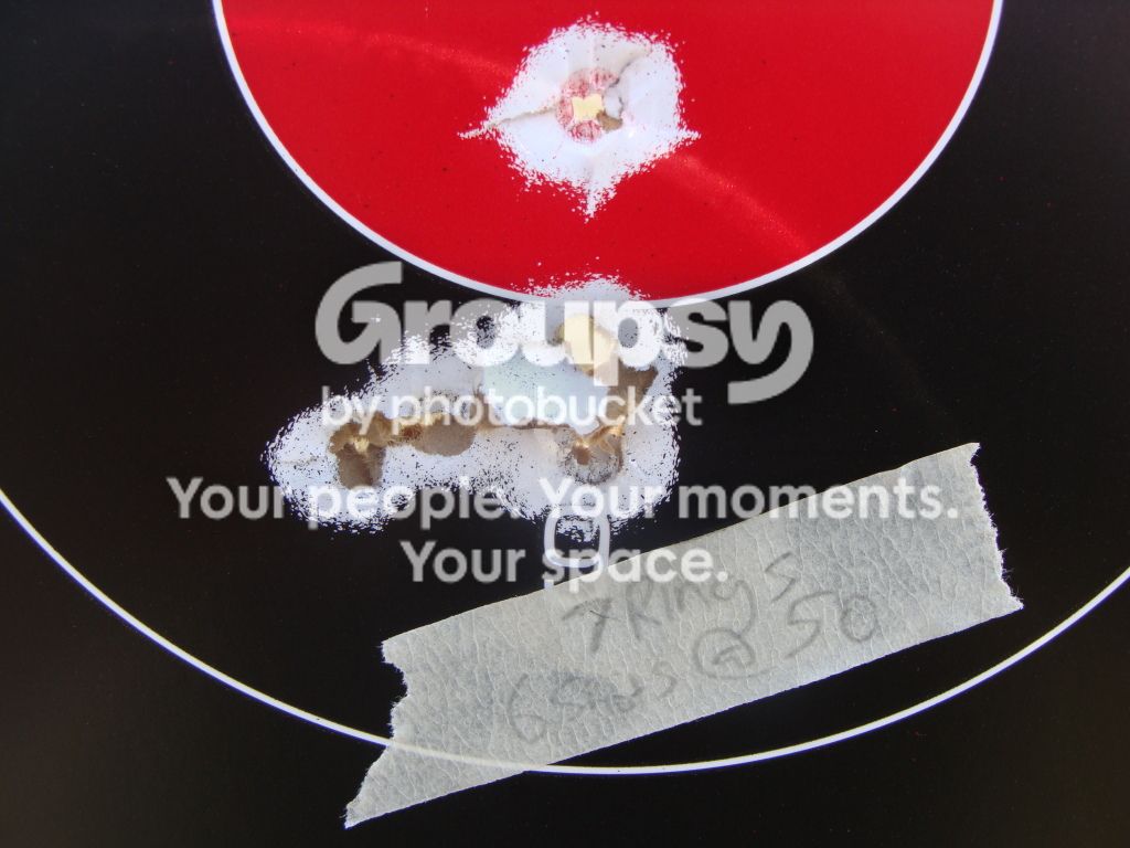

Here are a few pictures of groups with the 70.6gr 7 rings out of my 24″ condor. 5 to 10 mile an hour crosswind. I did not test the speed on them, but in the past they were moving at a speed of 798 fps for a 100 fpe. That was with my powerwheel on 7 (the setting where I leave it at for the jsb kings…) Without messing with my tophat at all, I put the preload on 11 and fired a few groups. One group was at 50 yards. It was a 6 shot group. For whatever reason the 4th shot of the six went high. If not for that 4th “flyer” this would have been a 1″ group.
Then I moved on to 100 yards hoping to top my best group and I am happy to say that I did so today!
The first group was a five shot group. If not for the fifth shot in this group that would have been a four shot group under 2″ at 100 yards!
and now the pic of the “flyer”
This “flyer” made me decide to only go for a four shot group (the last group of the day). I was happy with this 2 1/8″ group as I believe it bested my last try by 3/4″. I am curious to see how much faster the extra preload gave me (if any). I always felt that I needed more fps for these 70 grainers at distance…I will check it when I get a chance.
The second group (three of the four were nearly MOA!)
Today’s time spent at the range merely reinforced a feeling I have had all along…I may buy and sell airguns all the time…but I am never selling my AAA .25 condor! That’s a fact! 😎
