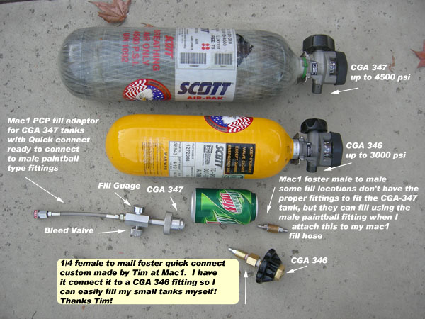

hey guys some help here, i got a scba tank and non of the places i took it can’t fill it, looks like i need a adapter or something to make it work, if anybody knows what kind of adapter and where i can get it would be great here is my tank valve
http://gallery.me.com/vhag/100066/DSC03128/web.jpg?ver=12499480790001

in the picture it is the mac1 male to male foster:
I use it with the mac1 fill adaptor.

That is a scba tank or cga-347 (4500 psi)
the adaptor that airtight_python posted is only rated to fill your tank to 3000 psi. (I think)
If you already have a fill adaptor to fill your gun from this tank, you may want to look at a Male to male foster fitting.
so you can fill your tank using a paint ball type male foster fitting that most places have a connector to fit.
Roger
I asked Joe B. about this. He said they were rated to 3500 or 4000 (dont remember). But he also said, worst case scenario is the o-ring would just leak.
do you know where i can get it and what does it looks like?
Roger
thank you AP thats what i need, hey saw if you want to sell your adapter i can buy it from you let me know if does it look like this,
do you want to sell the adapter ? how is it, sport chalet can fill my tank to 4500 but they don’t have the fitting let me know
Dive n Surf up here in So Cal would have no prob. with that, also check fire extinguisher places.
That there vhag is what I wished I would have got from the get go.
I had to buy an adapter from JB, cost me $90.00.
D&S can fill without it but only to 3200.
