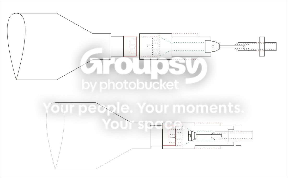

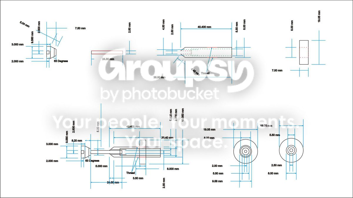

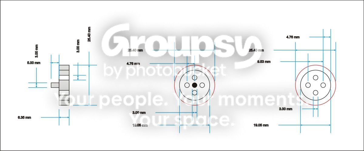

I think my earlier drawings were not clear enough that is why no one has given their observations. I have posted new & clearer drawings now. I hope to receive some opinions now at least.
All you senior members please see the drawings & suggest me if I am going in the right direction or not. It’s my very first attempt & want to keep the mistakes to the minimum.
Thanks
Karizman

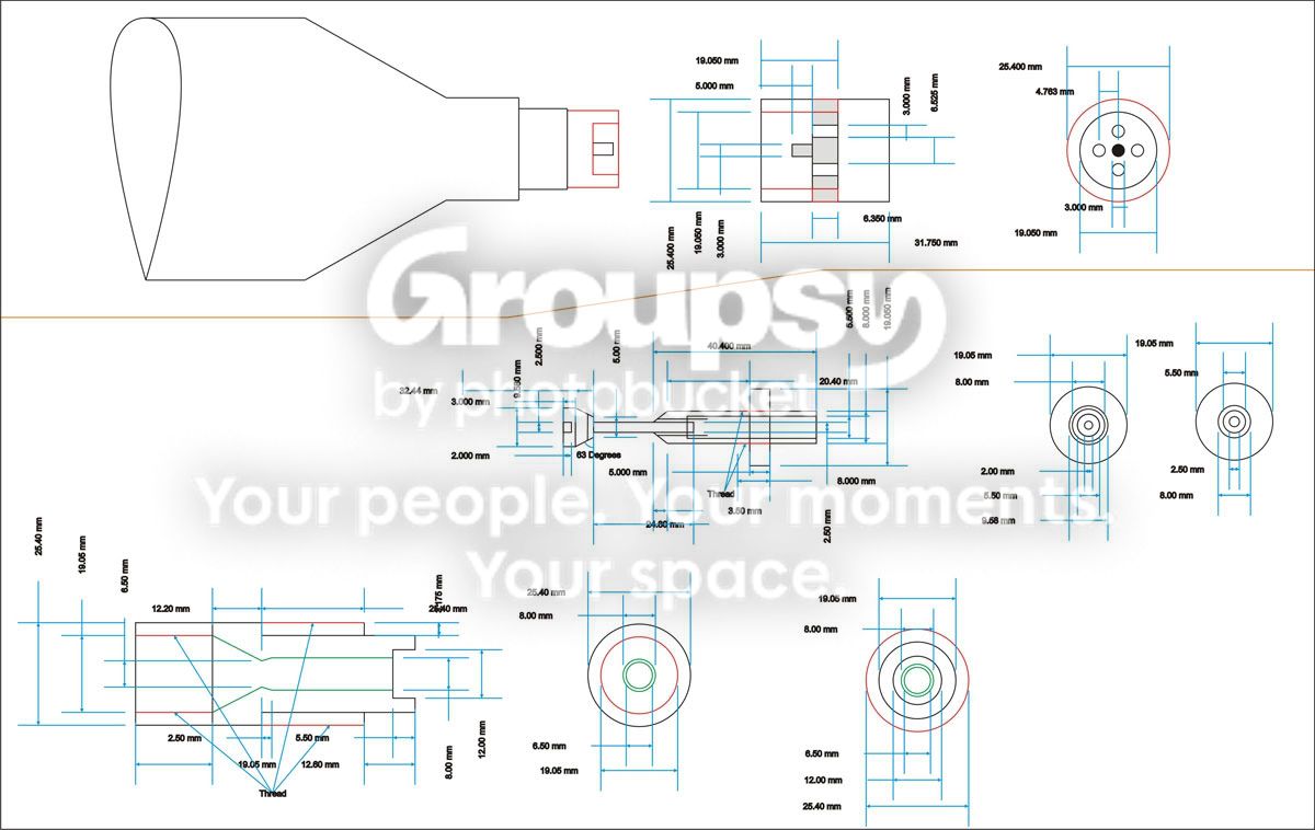

Here are drawings of my adaptor & valve. You suggestions are very much required.
Thanks
Karizman
