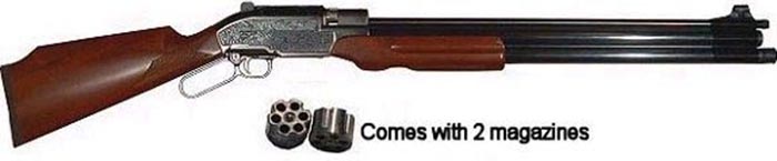

Sumatra 2500R in .20 Caliber has arrived
I decided to treat myself to a new rifle since I passed my second Block of computer Operations school here in Keesler Mississippi WOOT!
Had one hell of a time deciding between the Sumatra and the Career III in .25 caliber but what finally did it is I already have the .25 Career II carbine and they had the Sumatra .20 in stock at http://www.Pyramydair.com … I ordered it yesterday @ 11:45AM and it was here today before 3PM!!! of course paid $70 for overnight but damn it was here in prolly less than 24 hours! I don’t really like the clips on the Career’s also so that was nagging in the back of my mind also…
Opened the box and DAMN this is one hell of a sweet looking and handling gun so far! looked and it is already partially 1/3 charged 😀 BUT the adapter I bought for my SCBA tank is missing a seal? as it wouldn’t seal enough to charge the gun 😕 it was 6PM and the local SCUBA shop was already closed. Tomorrow I’ll get the part or rent a tank for while I’m here… On AOA’s site they list this gun as being able to adjust from 200-1,200 fps so I am REALLY hoping this gun can go low like that? my idea is being able to shoot pigeons inside barns and storage buildings but the gun has to be ultra low power to avoid shooting through the roof.
I took the scope, 4-16 BSA? with lasersight and flashlight mounted on it also, off my SS to set the gun up for now and with the high mounts the scope is TOWERING over the gun but it might need that to keep my head from getting too cocked sideways? I ordered some extra 30mm rings also as I want to put my Nikko 10-50×60 on it after Thanksgiving. LOVE this scope and I think it will look really bad ass on this gun.
Since Pyramyd does the buy 3 get one free pellets I got 4 boxes of the .20 Crossman Premiers(I sure hope they shoot good!!!) and cleaned and lubed them up with Slick 50 One Lube then rolled them around on a paper towel to get off the excess oil, lead dust and shavings… I will order some JSB’s when they get them back in stock Nov 2nd 😡 these suckers are always out of stock!
I read somewhere that this was used to good result with the field target guys if I remember correctly? it’s synthetic and should have a very high flash point. I have some other super uber pellet lube but of course it is not here but in Ohio…story of my life 😆
I tossed out 3 cans of cat food and 50 lbs of bird seed at the public hunting grounds last night in hopes of attracting any kind of living things other than mosquitos and ticks 😡 😆 I have seen Racoon tracks and deer poop as well as some Crows flying over so with any luck I’ll get in some target shooting as well as some hunting.
Of course I left my Chrony at home 😡 so I might have to see how this “softchrony” works on the laptop? I don’t see a microphone on this thing though….
Pics and initial shooting report tomorrow….

I was going to get an AR6 but the AR6 doesn’t have a pellet seat.you load the mag and the air pushes the pellet thru the mag and into the barrel. Blows air out the side of the mag. I didn’t like that.
With the sumatra, the pellet is seated in the barrel and the air comes for the barrel. Like most airguns.
great info i was wondering about that….back 10 years i saw a a korean rifle with mag just like the sumatra, but with no pellet probe, the mag sealed with orings…as they got worn it would shoot out the sides…another thing that cant help accuracy is the pellet being shot into the barrel…and what would happen if the indexer misaligned a pellet was pushed with 50+ fpe into the barrel wall….could possibly come out the side of the mag
The AR6 came out about 10 yaers ago. They didn’t sell very good so they stopped the import.
pellets coming out the side of the mag sounds dangerous!
how much power is your 2500 long rifle doing in .25 ?
