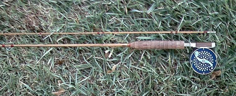

You mean like this? One of my creations. Splitcane Bamboo
