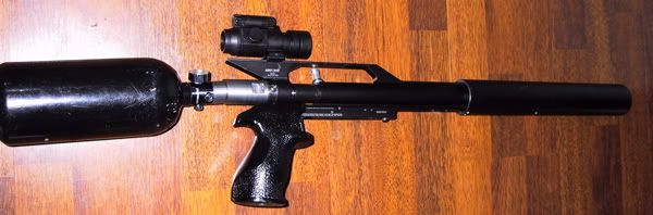

I for one, am hoping for a way to get it all in as short a package as possible,,I have bought a straight E-Tac, and one with the drop/cant…had to sell them both (and lose a little money) simply because they made the “pull” too long 😥 😥 .and I REALLY would love to have an air pressure gauge with a regulator, on my TSS….I have a jds bottle and 1600psi reg on my HPA Crosman 2250 carbine and it is GREAT…would love the same set-up for the TalonSS.just my $0.02 worth.

One last thought on the E-TaC-T-REG. How about a design like the guys in Argentina were playing around with a few months ago? Drop down at a 60 to 70 degree angle for 3/4 to 1″ then straight back with the reg & bottle. This would create a substancial pre-chamber for the regulated air withought adding much length. Would also keep the straight lines of the gun. Just a thought you might take to the front porch with a couple of cold ones and mull over.
Good luck with the shroud idea, only adding 2” to overall length might change peoples mind about longer barrels..

There is a LOT of volume to use there. The 12 and 18″ barrels will benefit the most as they will still be in the frame and get the most from that volume. It will take some coaxing to get the 24 to use the rifle-frame’s volume, but it will.

We had a member on the TOG that made some baffles milled out to the outside dimension of the front of the frame. He then mounted a shroud over the barrel and frame.
I tried to find the pictures in the gallery but could not find them.
It is a good idea

I am working on the 24″ barrel version and am pretty sure it will come all the way back to the power adjuster wheel like above, and about 2″ passed the barrel.

Three inches is really long guys… I have people giving up their 2″ long E-TaCs cuz they are too long. Remember, this is the Talon and Condor tank not some pygmy PB tank.
The length of the E-TaCREG is just right with the 53ci tank I have. I’m getting the last of the tools I need for production and they should be ready to ship the beginning of next week if you have your own JDS Reg. Honestly they will fit on any JDS reg regardless of the pressure. However, some of the other maker’s reg pistons are different diameters and will leak and therefore cannot be used.

The T-REG is quite a project. Much moreso than I first anticipated.
The length of the reg plus the chamber plus the valve have made it too long right now. (in the <gasp> three-inch range) A redesign and reengineer of the valve may be required. There is lots of wasted space in there…at least an inch for sure, probably more. It is ongoing and productive, just time consuming. I have to design, build, think, consult etc. So when I’m at an roadblock, I do something else, like the MegaMod.
Good news is the second generation of the E-TaCREG is in on the gun and working very well.
