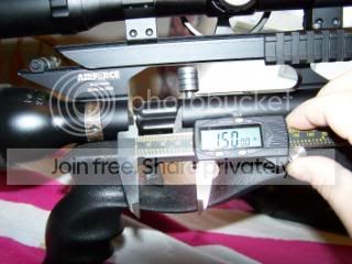

My talon and my condor measure the same. Breech cutout is 1.498″, probably 1.500″ is close enough. this is the cutout only, not measuring the collar area.
Breech length is 2.005″ so probably should be 2.000″
The knob hole centerline is .475″ back from the front face of the breech.

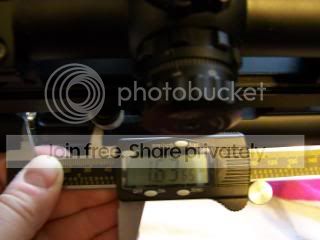

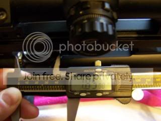

Is this of any help? It’s supposed to be a talon. If I understand which measurement you want…2.5mm is .0984″
