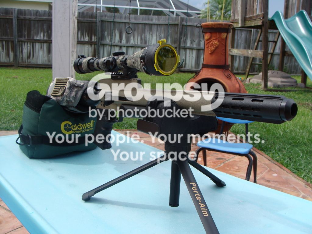

Something like this…
I have a feeling if and when I get a .257 TJ barrel, this will be the frame it is going to go in…I can’t imagine this will have any frame flex. The left side of the breech is filled in solid as well….[/img]
