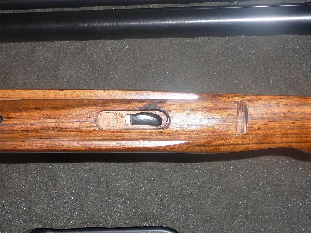

Those pictures look like someone took tried to destroy a rifle and the inletting is the worst I have ever seen, even by people who don’t charge money for their work and are just experimenting with stock building for the first time…

OFF CENTER INLETTED STOCK:

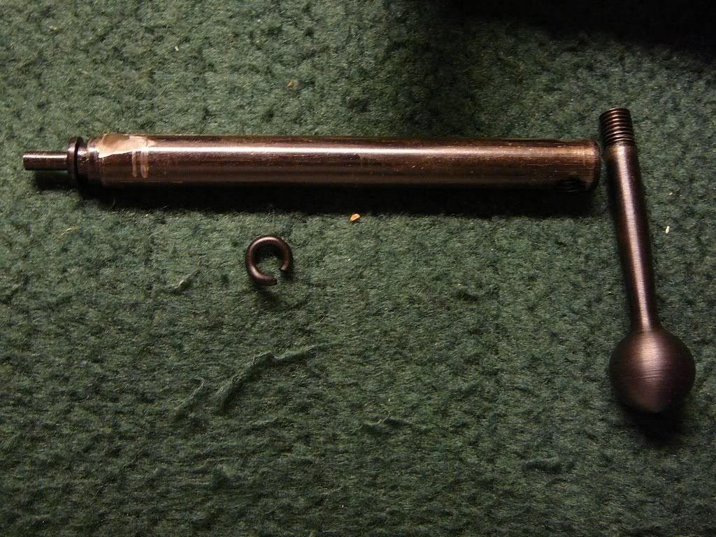

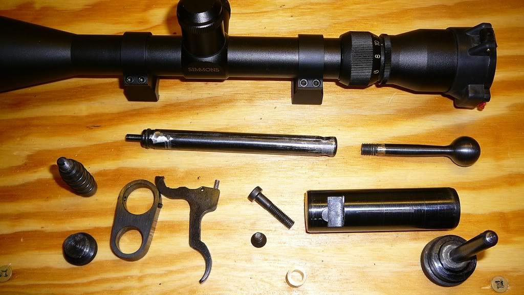

BOLT PROBE THAT WAS GROUND DOWN TO SLIDE OVER HOLD DOWN SCREW IN RECEIVER….aaaaarggghhh!!. BOLT PROBE STILL WENT OVER SCREW HARSHLY. ALSO, THAT TRIGGER IS NOT NICE. IF IT BREAKS, I’M SCREWED. ALSO, BRASS TRANSFER PORT IS DRILLED OFF CENTER:
ANOTHER VIEW OF THE BOLT PROBE and a BRAND NEW O RING WAS BLOWN IN ABOUT 26 SHOTS. While IN THE FUCKING FIELD AND I WAS 2 HOURS AWAY FROM HOME WITH NO SPARE ORING………..aaaaaaaaaaaaaarrrrggggghhhhh!!!!:
This is the 1 year old 457 and i did not take pics of other issues. But oh yeah, you can bet there were definitely more issues
