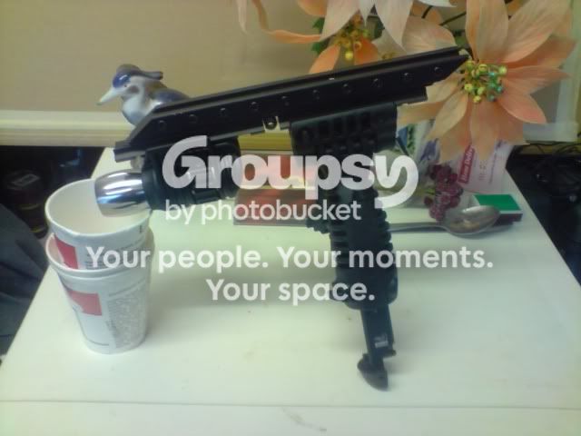

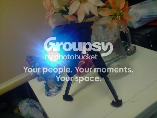

i also wanted a weaver mount on my rifle for various accessories, so i bought 2 adapters, and once again attached them to the tri rail 😀 here’s a few pics of it, will post more pics very soon of the new set up, as previously it was a little heavy 😀 and i do like the wooden look on it, but i orignally purchased my rifle for the “state of the art military looks” and i think the way it’s going now certainly compliments that, as it weighs a heck of a lot less then the “heavyweight wonder” in the gallery, will be a short while before i finish this set up though 🙂 Plus now i can still use the stud for a sling, so i left it on.

Strewth m8, that does look good, very neat, smart looking good.
