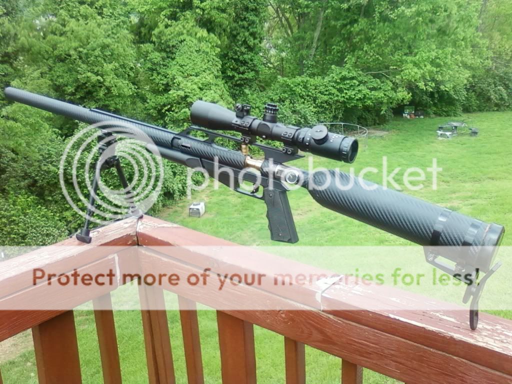

My Carbon Fiber Condor
This is my carbon fiber condor with Tonys valve, custom brass breech by Pris D, Tonys custom trigger shoe, 800cc bottle, wok trigger guard and wok butt, m1911 grip, etac by my buddy Jim Gaska in 25 cal. gets 127fpe with jerrys 7 ring at 902 fps.

He just had one he was selling. The bottle is just like the stock bottle just bigger. It cost less than the condor bottle. No adapter is needed I put the etac on it to know what pressure was in the bottle. Not sure how much the bottle was because I bought the brass breech too but it was a lot less than the stock condor bottle.
Does Paris D sell the tanks or he just had one? How much was the tank and do you need any adapter to screw the AF valve in to the tank?

What is on the end of the tank?
I got it from Paris D. I also got the 800 cc tank from him. The breech works great no problems it has been thru 200 Jerrys slug and about 4000 pellets and cast bullets. It rides on the barrel and does not touch the frame.
who made the brass breech? looks like something off leupys site 🙂 do you have any problems with wear or scoring on the barrel? my first stock breech split in 2 when i pumped 3300 in my TT tank… 😥

The secret to applying the wrap is to use a heat gun. This helps form it on the contours of the bottle and the gun. It comes ready to apply no glue needed just peel off the backing which is some strong stuff also. The wrap is thin enough to work with easily.

Hey guys this wrap is really tough stuff I don’t know if it is real carbon fiber and don’t really care because it does the job. To be honest I doubt it is actual carbon fiber. But if it last on cars moving at 70mph or faster it must be tough. I wrapped my sons dirt bike seat and it always springs back after riding all day. The breech is all brass and makes the condor more quiet and adds a little power I am using the stock condor hammer. I have a custom hammer from subssonic that will give me even more flexibility with the valve I am working with.
