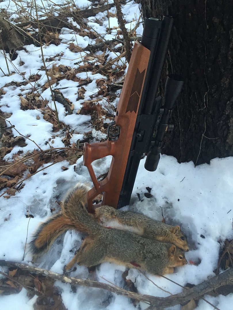

Way to go TT, I dropped 16 tree rats late last year in one day with my Vulcan.
Well done! Those are healthy looking squirrels. If you’re in the US, you might want to save the tails for fishing lures. I think Mepps is still trading/buying them.
