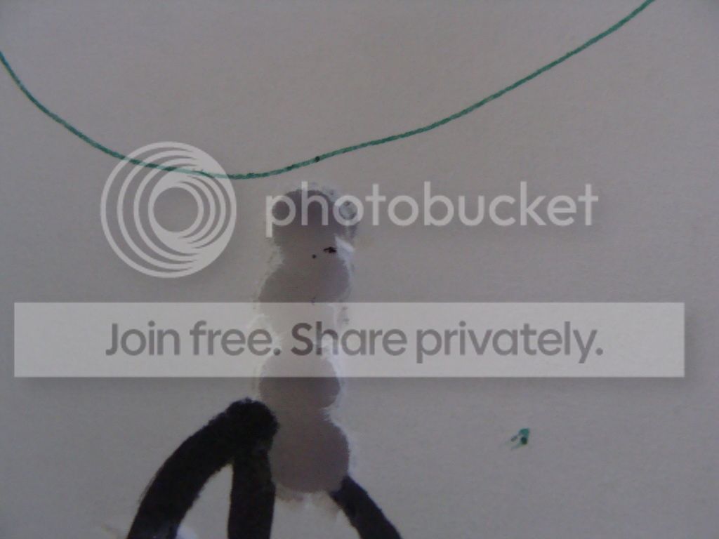

Im not so sure a chrony will give you the reason.
A few years ago I shot quite a bit of groups over the chrony. Almost all of them were vertically strung.
One looked almost exactly like the one you posted. All shots edge-to-edge, vertical line. All 5 shots were barely subsonic, and the chrony reported 1075fps for each shot.
Yea, I had to look twice each shot to be sure it was recording.
Velocities were always very consistent with those pellets, and the accuracy was always weird.
Maybe, somehow, they know what a pretty hole they punch in paper and they want to create their own hole punch 😀 Since my .25 shot the Crow mags so nicely, I want to try them in .22. I have to dig through my pellet overflow box to see if I have any.

I wonder why the Pred’s are doing that? 😕
Mike, I am stuck on Desert Tan, OD green, and black. Some of the best colors out there, IMO.
Rif was wondering the same thing. It is very odd indeed. I suppose it would be helpful to have a chrony on hand when the “phenomena” occurs 🙂
They almost fired in the same manner in that other group in my picture. The one to the right was most likely me so if I didn’t pull it it would have been a dam near identical, vertical climbing group. I probably should have fired from my bag instead of a bipod on bricks. Groups would have been a tad tighter for sure.

Thanks Rif, now that I think of it, I do recall the predators mysteriously rising???

I see predators doing that often. Ive got a lot of groups that string vertically, while other pellets do not. Never figured out why because they do not shoot like that from the S410, only out of the talon.
Having said that, they still manage to find the head of starlings at 30 yards, time after time.

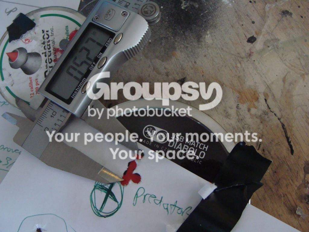

The first groups I shot was with the Monsters 25.4 gr on a 2800 psi (sorry, no chrony right now) and I honestly almost crapped myself as the first four shots went into the same hole at 25 yards then the fifth was a hair outside giving me a group of .328! Unfortunately that was the best of the groups. After they averaged 1/2 to 5/8″ (same 2800psi fill pressure) not too shabby.
I was surprised that the lighter 16.13 gr exacts did so well at both a 2800 psi SP and a 2000 psi EP 38 shots later. They surely stayed subsonic and I want to chrony them to know for sure soon. They did best at an average of 1/4″ to 3/8″ 5 shot groups over and over again.
The predators were not too bad either. They averaged 1/2″ to 5/8″. Check out that nearly perfect vertical climbing group with them. Every shot seemed to touch the top of the previous shot and if I had a chrony perhaps it would have showed each shot climbing in fps.
