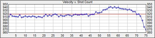

Ok. here is new string.
Cranked up the HTS a bit . Looks like average is 914 for first 50 shots then climb and fall. looks like I lost about 10 shots from the last string.
What you guys think?
1 910 – 200 bar
2 918
3 913
4 912
5 911
6 910
7 916
8 908
9 910
10 913
11 910
12 912
13 910
14 913
15 911
16 908
17 911
18 910
19 908
20 913 – 170 bar
21 918
22 913
23 916
24 913
25 917
26 919
27 917
28 911
29 915
30 913
31 913
32 915
33 917
34 915
35 913
36 916
37 918
38 916
39 916
40 918 – 140 bar
41 917
42 918
43 919
44 913
45 917
46 918
47 918
48 926
49 922
50 923 – 125 bar
51 925
52 932
53 933
54 935
55 940
56 942
57 938
58 942
59 938
60 940
61 937
62 936
63 935
64 935
65 932
66 934
67 931
68 927
69 927
70 918 – 100 bar
71 919
72 913
73 898

F and D, That string is lookin pretty good! I know that you didn’t ask for any advice but, that has never stopped me before! 😆
You are getting very close. You could up the HST a little, start the string at 910 and see if the hump flattens out or, the regulator could be turned down just a little more. If you flatten the hump out you might pick up another shot or two.
LOL I am always looking for advice! =) All I have been doing today is playing with rifles and shooting whole lot of pellets through the crony laying on my belly in my bedroom. LOL
I will turn HST up a bit and shot another string. Stay tuned for results. LOL.

But I think you need just a tad more hammer strike (from what I have seen in zoc’s and other tuning posts), that will probably add some fps to the beginning of the string. It looks like the hammer is finally overcoming the pressure and so the fps climb 10-20 fps at about shot 55 and then falls off the reg 20 shots later…
I think the initial velocities should be in the 920’s and just stay around that (+/- 5 to 7fps) for 60+ shots and then fall off the reg at about 130bar… This is with the 18 grain pellets of course. (Apparently this is the “standard” from the factory).

Ok. Here is what the shot string looks like. 😯
I love my R3 25 now! Difference is Night and Day!
50 regulated shots of 897fps +/- 3 then small climb up to 920fps for 30 more shots!
