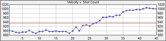

Pls help w/ shotstring R3 .25 Long =) – and some new Pics
I have finally shot my R3 .25 Long through the chrony.
I have a feeling that I need some major adjustments =)
Can you guys chime in. Will I be able to lower the speed with hammer adjustments or just go straight to regulator adjustment?
Why such high variation in speed?
Here is results.
60 shot string. ProChrono w/ IR lights.
Starting pressure 200 bar and last shot is at 110 bar.
This is what shot string looks like … eeeek!

Little help please =)

Ok I didnt mess with the rifle yet.
I refilled the gun to 200 bar again and shot another string of 45 shots.
Shot #23 is at 165 bar and shot #45 is at 130 bar.
1 901
2 898
3 893
4 891
5 894
6 894
7 902
8 892
9 888
10 896
11 897
12 903
13 896
14 897
15 898
16 896
17 896
18 896
19 888
20 899
21 918
22 899
23 924 – 165 bar
24 927
25 921
26 933
27 937
28 946
29 962
30 962
31 966
32 964
33 972
34 971
35 987
36 992
37 995
38 994
39 998
40 997
41 1000
42 1006
43 1004
44 1002
45 1000 – 130 bar
Well, I’m way behind old goat and others on this, but my guess would be that you will need to turn the regulator down. My guess is that it’s coming off the regulator after ~ 20 shots, which is where you start to see the big spread in speed.
