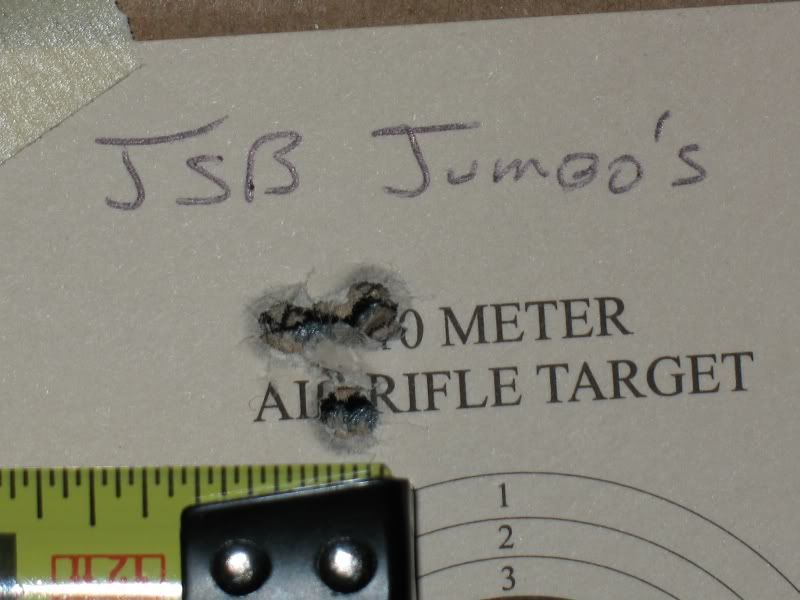

Groups I shot with Fred’s rifle at 40 yards last Sunday morning. We had high winds coming in that day so I got up before daybreak and got the targets up and rifle rest ready. As soon as I could see the shooting began.
The wind was gusting in the tree tops around my place when I shot this group .. I just waited for it to lay down as much as possible before taking each shot.
