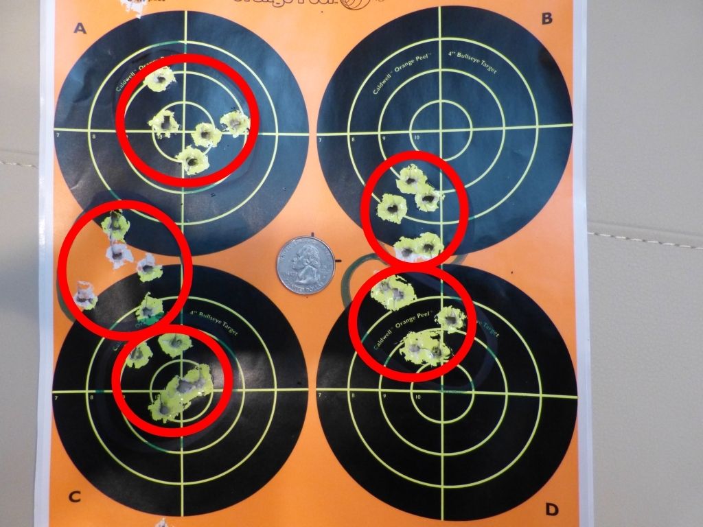

R3 .25 Matador – "out of box" accuracy at 100 yard
This what I was able to achieve while sighting in my scope.
The point of impact keeps shifting because I was adjusting the turrets. I started on the left upper target and got the group in the middle of the two, left targets. Then I went to the right upper; then the right lower; then the left upper; then the left lower.
All groups are 1.1″ to 1.5″ (28-38mm) CTC. Pellets were JSB King 6.35mm (unsorted). The scope – Hawke Sidewinder 30 Tac 8.5-25x (shot at 25x). There is much to discuss when comparing my
R2.5 to this R3. I’ll get into that in the video.

Every Matador is different.. When you stick within the same size and cal it’s still doable to shoot right away good groups.
But when you’re used to shoot a .22 standard and you take a long or short, it’s already different.
You’ve gone from a stand .22 cal to a long .25 cal, so.. it’s perfectly normal you don’t shoot the same groups.. YET!
When you see those groups now, they can only become better! My new .22 shot better groups out of the box, but now after 500/600 pellets groups starting to open up.
I have 2 possibilities: I need to clean the barrel or it was due to the warm weather. Got a report from a friend that his groups opened up also.
So, maybe nice to keep track of the amount of pellets you’ve already shot..!

Hey Ted, I was just curious… You mentioned that your .22 was far more accurate at 50y than your new .25 because of…. you’re more ‘familiar’ with your ol’ trusty .22 than the .25? Perhaps the .25 just needs to be broken in? Would love to hear your opinion on the matter. Thanks!
A in san diego…
Oh – ther is NO doubt my skill and knowledge of the gun played its part. I was averaging .5″ groups (at 50 yards) and 2″ groups (at 100 yards) with my .22 R2.5 when I first got it. By comparison, I am doing much better with the .25 R3.
