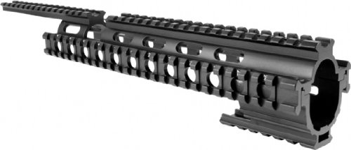

The drop-in installation is more easy: first, install the Quad rail; then, drop-in and tight up the installation-screw. Second, hook up trigger-link and close butt- cover; then, tight up by end-cap screw.
All material is Aluminum and hard plastic (partially rubber), the cost is planned about $100, quad-rail (RIS) remains same as per request of my hunting group guys.

I always used aftermarket RIS (Rail Interface System) with minor modification. Because Ruger 10/22 is the most popular Rimfire and many aftermarket parts and accessories are available at lower price
Walmart is selling at $25.01:
http://www.walmart.com/ip/Aim-Sports…-Rail/21066500
