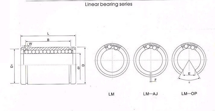

But, I used 2pcs of 3mm dia. liner bearing bush ($2 each plus $6 s/h) for my own unit as extra.
