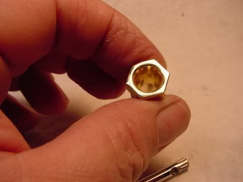

Syn, normally you would be correct. However I did the valve mod, and the shroud myself. Both work just fine! I would like to get the hammer slap mod figured out, along with the o ring mod for the valve. I’m getting some blow by. I wonder if Tony keeps vqalve parts around so that an o ringed valve body can be ordered from him?.

MIke Here is a shot of the valve body. http://i147.photobucket.com/albums/r294/mlovett_photo/DSC01383xxxxxxxxxxxxxxxxxxxxxxxxxxx.jpg?t=1202536534
