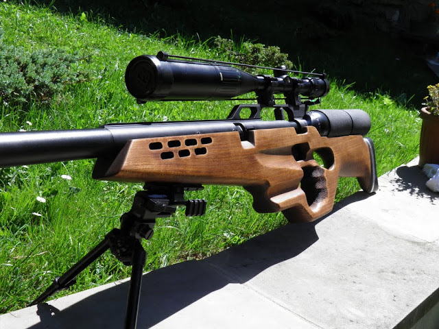

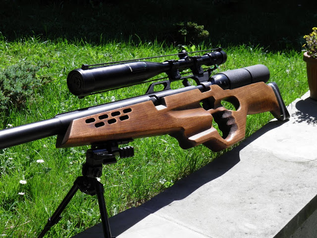

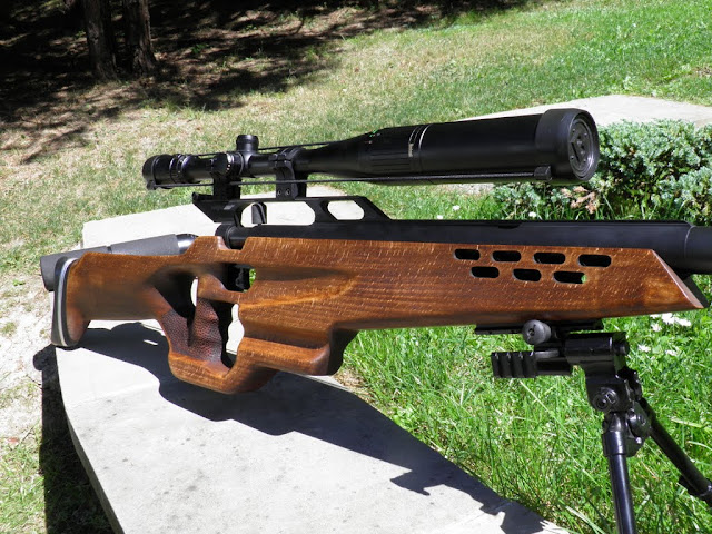

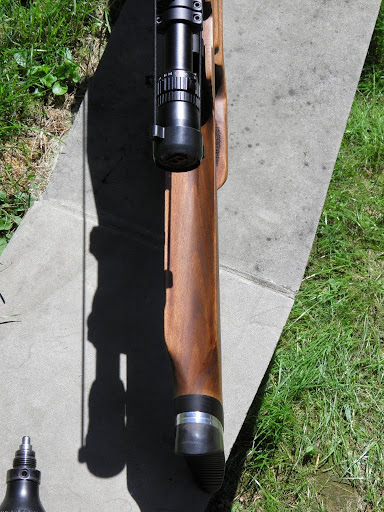

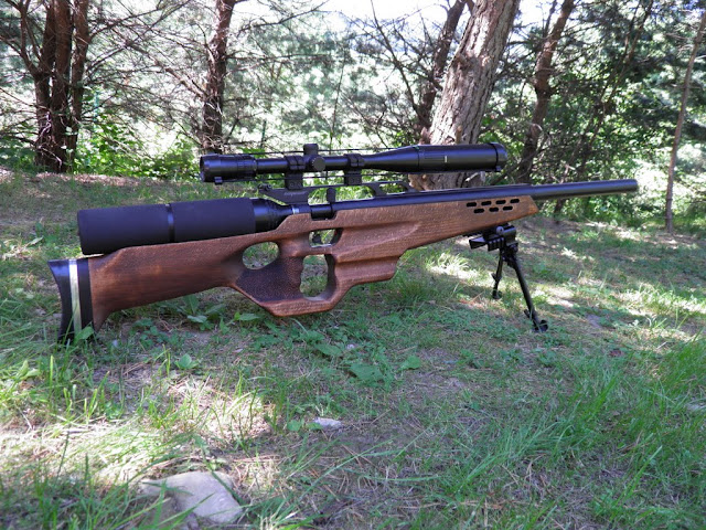

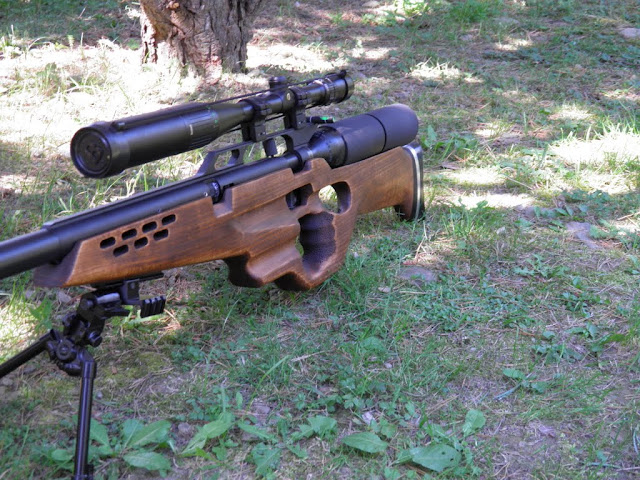

Thinking of makeing stock like this for Condor
What do you think?

Very nice!! 😀

Nice RiffRaff, mine is attached only on one screw the one in front that normally holds the front grip.
Its a great start Lupii. If you ever decide to use the angle adapter like RC suggested or if you decide its just too heavy, you could remove the rear half behind the grip.
I once had a full length stock, but over about a year I finally whittled it down to just the grip/foregrip section.
Like you, I loved the way the rifle shot with a big stock but the weight finally got to me.
The frame flex issue is still completely eliminated.

If you made a sporter version of it without the FT influences it would also make it much lighter for those that would use it for hunting.
You have done a great job so far tho.
