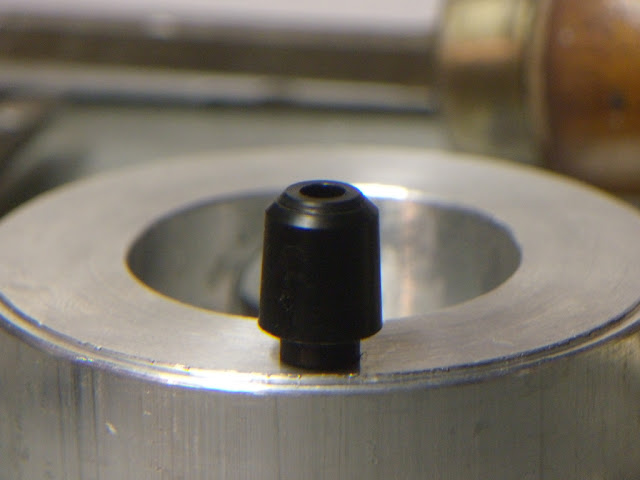

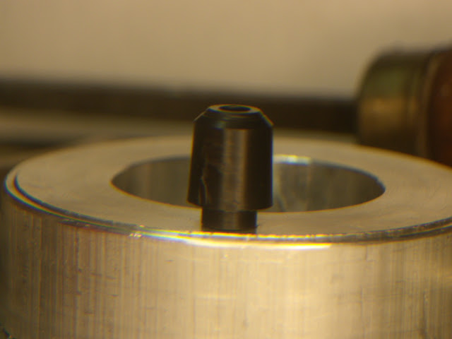

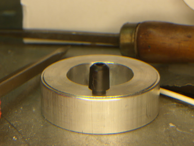

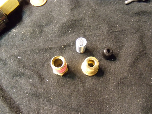

I think SS is on the right track. We need his expert opinion here on the beveled surface of the Valve Seal.
To me it looks like there are a couple ridges grooved into it. One grove would probably work OK if it re-seated the exact same way all the time but 2 or more separate groves indicate inconsistent seating and possibly a source of air bypass. I’d get a new valve seal from AF and align things carefully to make sure it doesn’t take a off center hit.
Someone could possibly resurface the valve seal but I think it needs to be done on a very true lathe. Any wobble would cause it not to seal.

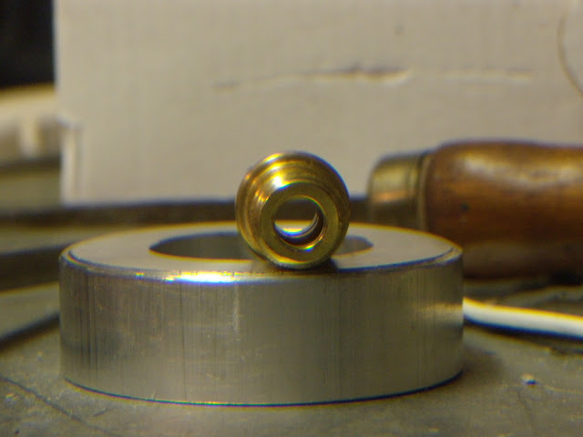

If the brass valve seat is not perfect you can get a new one from AF fairly low cost.
Oh, if your valve stem is bent a little, that could be part of the cause the problem also. If you order a new one, get 2 while you’re at it. And order the grub screws as they don’t come with the top hat for some dumb reason.

Seal and face look fine. Sure the valve spring retainer was in enough? About half way in, then locked down with ptfe tape or loctite seems about right.

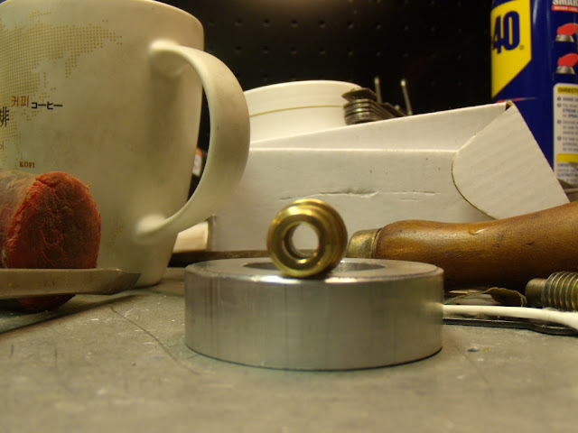

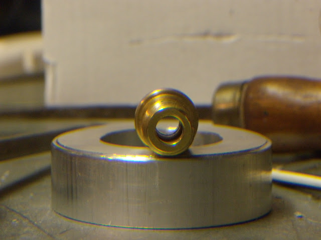

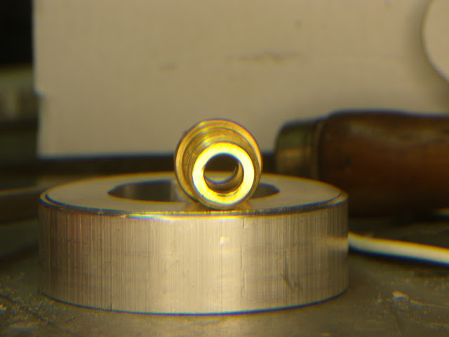

Also here are some better close up of the face where the seal seats up to..
This was polished with the dremel polish tampon and some auto polish 2000grit and another that’s 2500 grit so I doubt I deformed it but I guess that’s possible? thanks![/url]

Here you go! New trick to me but if you take the picture through a magnifying glass it gets a way clear picture on zoom!

if you still have the cam take a picture of side profile of the valve seal……
Here are some pics. Sorry for the delay I had to go borrow a digi camera as my cell phone one wouldn’t get a good zoom shot. Let me know if you need another angle or anything. Again I appreciate you being patient and helping out a newbie.
lets see some pics of the seal face and the valve guide that it seals against…. 😕

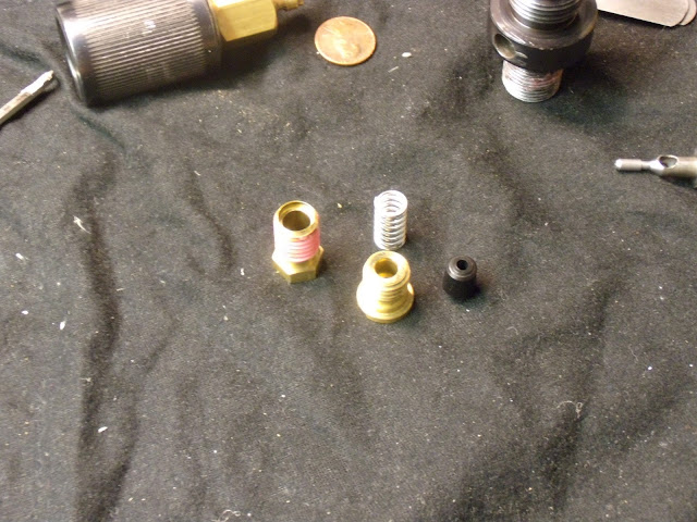

it never backed out so don’t think it that. i went ahead a screwed the retainer all the way down as I found it and well I must broke something during the first round of firing (filled to 3000 and fired 5 shots then problem began) because now when I fill the tank I get a constant leak when I bleed the tank from filling. Just hisses down. It’s coming out of the TH like it should so I’m guessing the seal isn’t sealing properly or the spring has lost it’s tension. I’m thinking the first one because there is a good amount of tension when trying to push down on the top hat. Any ideas? I’m gonna upload a photo of the valve seal. And the seal is pushed all the way on the stem. thanks for the help!
