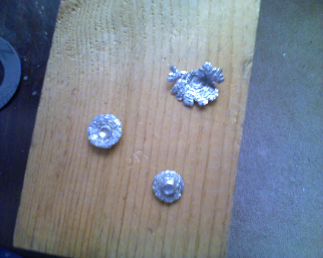

I shot a few more groups tonight but the wind was a major factor so I can’t judge the groups. I tried some H&N Ram Points and they are the worst pellet I have shot so far. The first 3 shots made a group over 10 inches at 50 yards so I put the lid back on that tin. I will give it one more try tomorrow morning.
