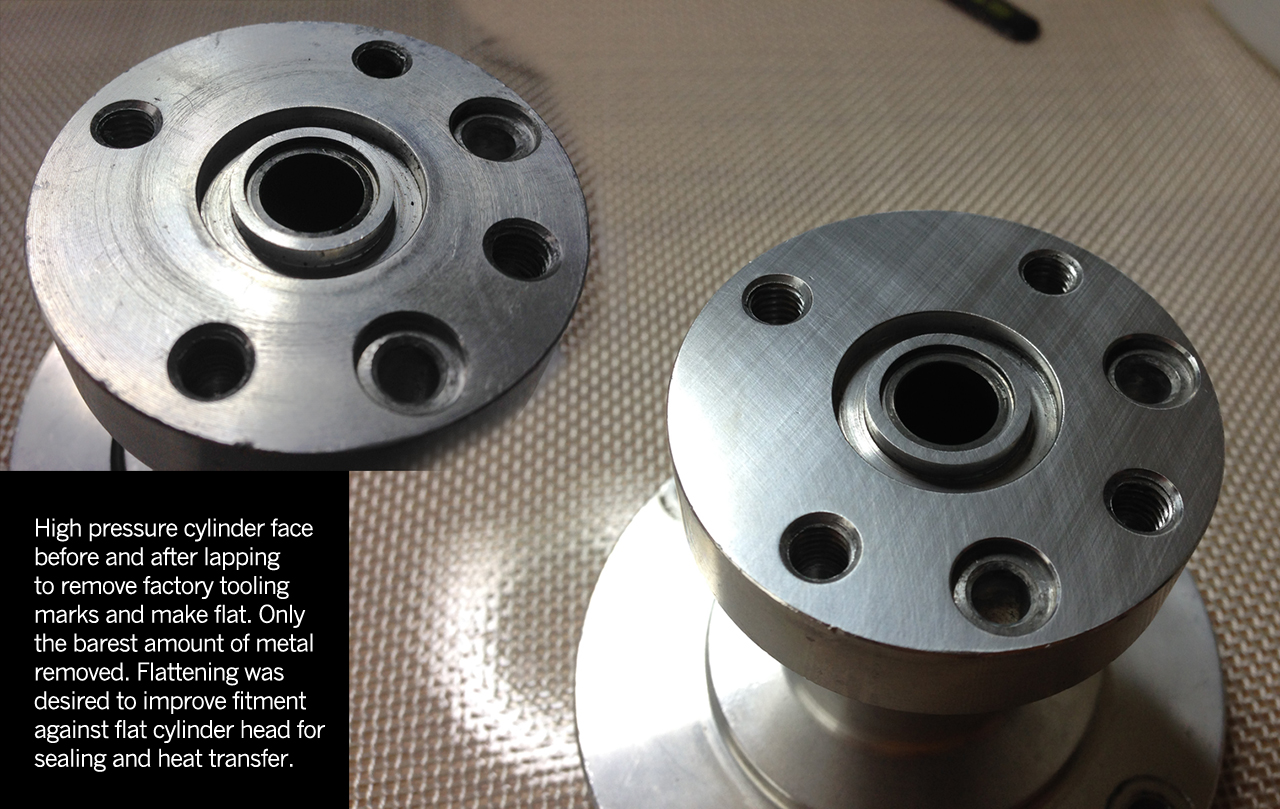

An incidental, albeit currently useless, side project was done for the high pressure cylinder. I wanted to improve the cylinder wall cooling and also keep the cylinder head better sealed and cooled.

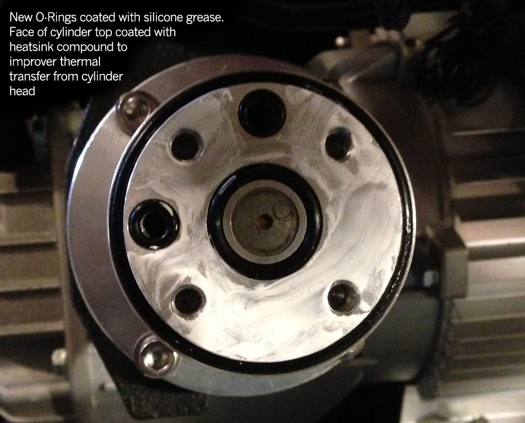

I lapped the top of the cylinder housing flat and used heat sink compound (silicone based) to thermal couple the high pressure head to the cooling system.
That o-ring around the reed valve wafer is prone to blowout due to high temperature exposure. I think that should be changed to a more heat resistant material like silicone, but that is for another day.

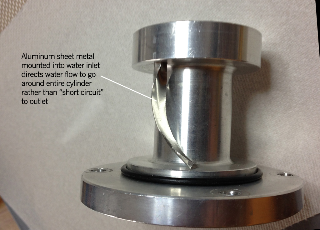

If you look at the water jacket, the inlet and outlet are near each other and could have a “short circuit” flow pattern. I wanted the cooing water to scrub along more of the cylinder wall. So, I added a piece of aluminum sheet metal at the water inlet. It is crimped into place at the top of the inlet. The shape promotes the water flow to go around the cylinder. Might not make much difference, but easy to try.
There still is a huge adiabatic heating that occurs. The only way to help that is to pre-cool the incoming air. The tube running from 1st to 2nd stage is short and doesn’t allow for much cooling. Ideally, a coiled intercooler would be there. Cost is an issue and I don’t have a source for HPA rated stainless steel coils with ends that would fit this machine. Perhaps cooling fins and a water jacket there (and on the output from the 2nd stage) would be possible.

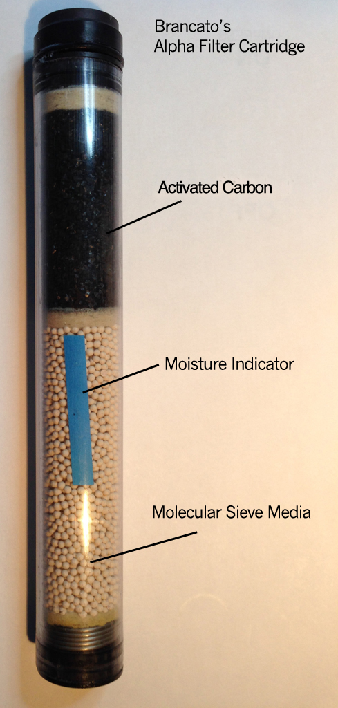

Once you have problems, the overall COO gets awful close to a dive compressor. Add $400 for an Alpha filter to get actually clean, dry air. you are nearly 2/3 of the way to a Daystate or Airetek. Add the value of time needed to fix it up and you ARE in the realm of a full scale compressor.
My Alpha filter saved me from getting lots of oil into my Great White and Vulcan. I didn’t understand how molecular sieve could scrub out the oil. I opened the filter and now see why it was so effective at keeping the nasty oil at bay. It has a activated carbon segment. I didn’t know it had that. Brancato never mentions that feature, but that saved my Great White. I would call this a must-have if using a compressor that has oil control issues and lacks a substantial size drying media unit and pressure maintaining valve. The Alpha takes care of that, but its cost shifts the total price point.
