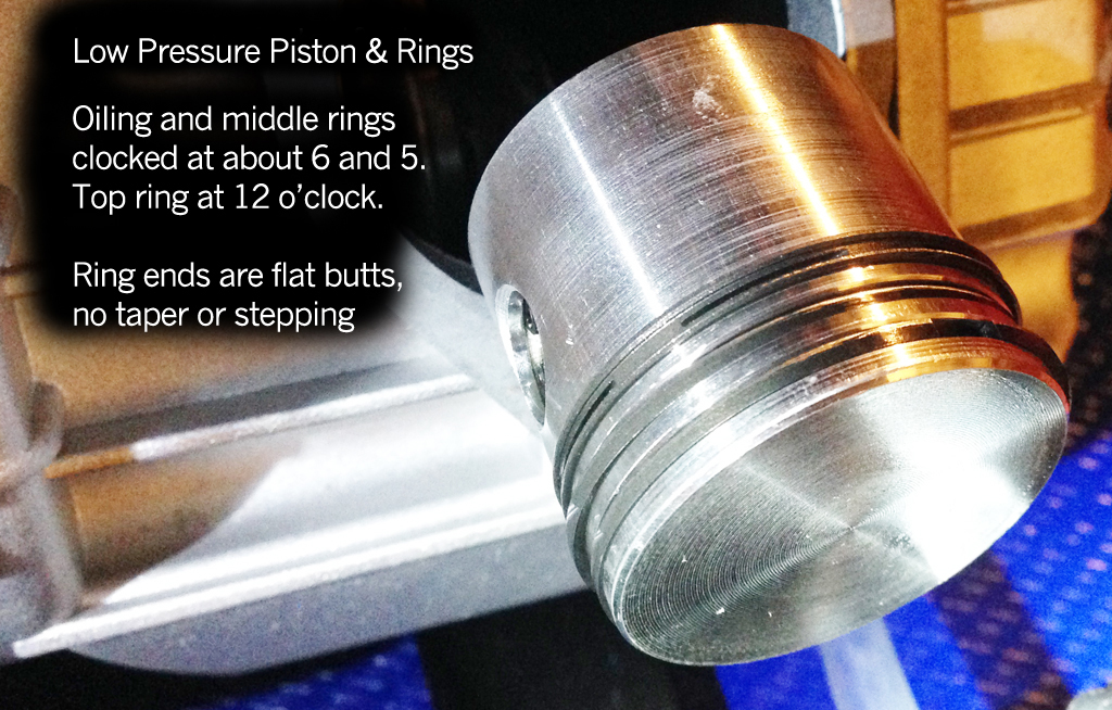

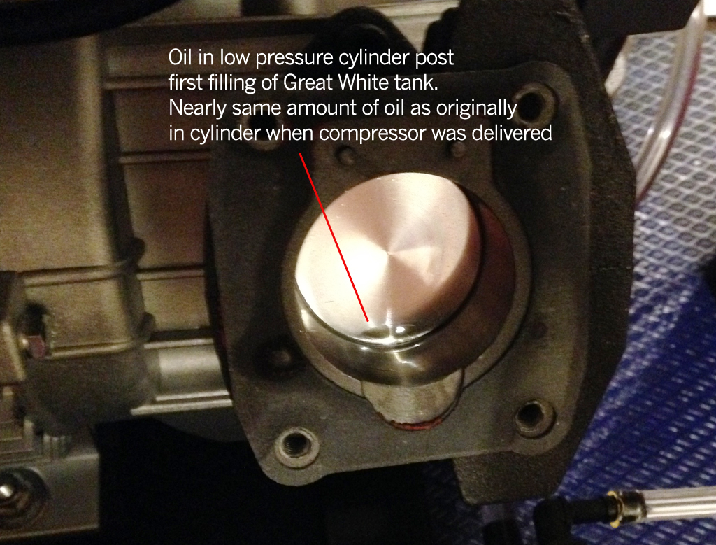

While I await reply from MrodAir regarding my three requests, I examined the low pressure cylinder to see what has happened.
The amount of oil in the low pressure cylinder is as much as when it originally arrived. I had assumed all that was due to it being shipped with oil in its crank case. My pre-cleanup effort was in vain. Plenty of new oil has gotten into the cylinder during my Great White filling attempt.
This time I pulled the cylinder off to look at the rings and piston. There are three metallic rings. The top and middle are simple rectangular profile. The oiling ring has drainage holes around its center. The bottom (towards crank) edge of the oiling ring has a sharper edge. The upper edge is beveled. The sharp edge down towards the crank seems correct direction to me.
Clocking of the ring gaps was the only thing questionable. The oiling ring and middle ring were at 6 and 5 o’clock respectively (nearly aligned). The top ring was at 12. Ideally, none of the gaps should line up. On the other hand, I don’t know how much these rings spin during run time.
Inspection of the rings and cylinder wall didn’t show any obvious defects.
Cleaned things back up and then reassembled with oil, middle and top rings at 12, 6 , 12 clocking to make each successive ring gap 180 degrees apart.
Recompressing the rings was pretty easy. The cylinder end has a taper that can do the last half of the compression. I just held the cylinder with both hands, fingers extending beyond bottom of cylinder. They I could curly my fingers around and compress each ring before it engaged the cylinder.
So, the gapping wasn’t ideal. I’ve improved that as much as possible. Don’t know if the gapping with change during run time. Also the ring gaps are simple straight butts. They are neither tapered or stepped. At least these rings are metallic.

1. Oiling problem in low pressure cylinder
Way more oil is getting into my low pressure cylinder than for some other owners.
Charles McKeown’s machine does not make his shop smell like oil and he says
he isn’t getting the oil staining that I am seeing with each bleed of the separator.
Plan: Examine the rings on the low pressure side.
Action:I remove the low pressure cylinder from the crank case and check
the rings and their clocking. If that looks OK, I replace those o-rings with
new ones. That won’t rule out the cylinder, but rings are easier than
an entire assembly
Need from Mrodair: I will need a set of low pressure o-rings and info
regarding the correct orientation and order of rings

Michael thinks the low pressure rings in my compressor are amiss, out of order, upside down, or gaps aligned. I have never taken down the machine far enough to see those rings. Only saw the top of the piston from the cylinder head removal. When I get a chance, I’ll try to get those examined. On the other hand, there really shouldn’t be a need for me to correct them (if they are indeed awry).
