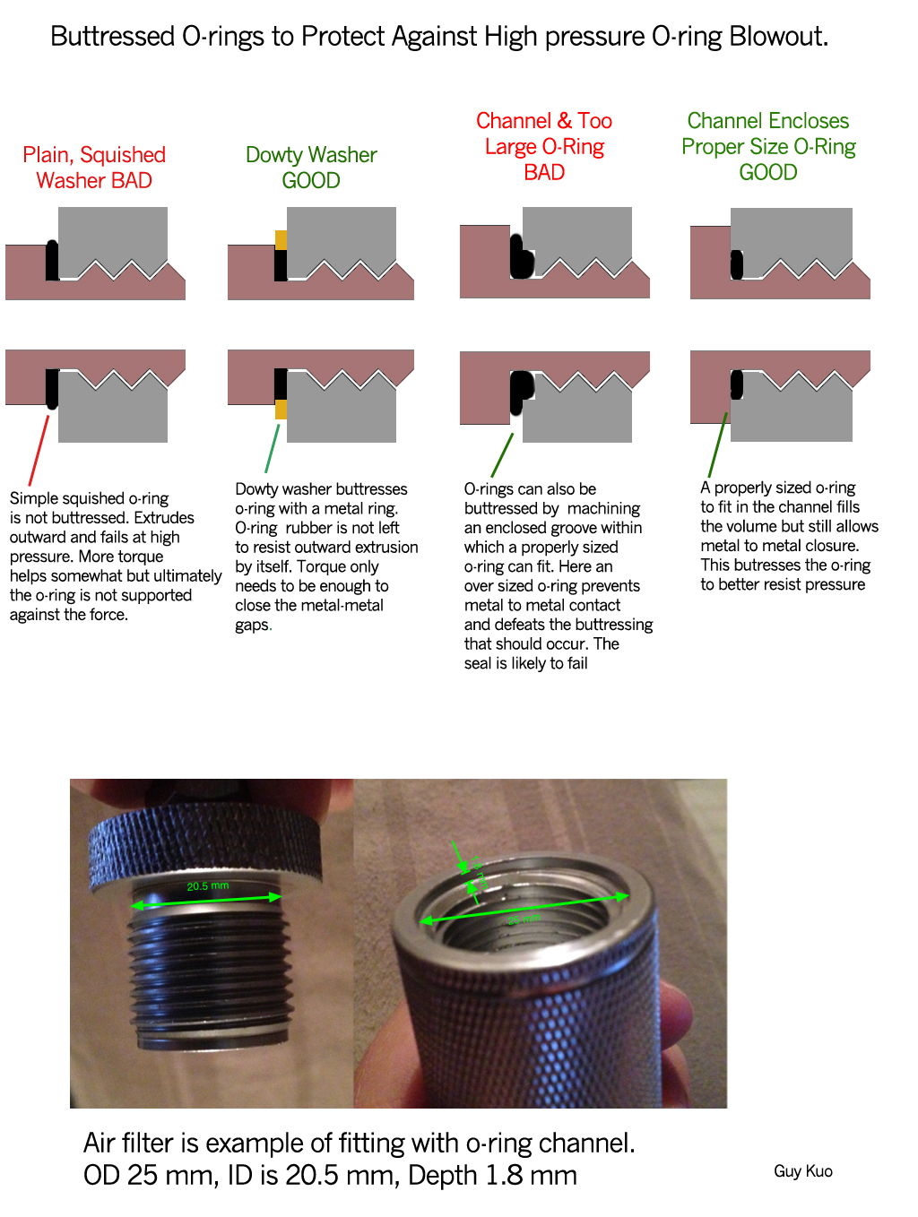

Here is what I meant about buttressing the o-ring. The air filter’s fitting is a prime example of an o-ring channel that is defeated by an over sized o-ring. The o-ring supplied with the filter is monstrously thick. It will never fit completely into the channel. Too large an o-ring means the fitting never attains metal metal closure to buttress the o-ring. This leaves the rubber to resist the force all by itself. Hence, they readily blow out.
The same problem happens with the o-ring supplied on the water separator poppet body. The supplied ring is too large and the fitting is prone to leak. It also destroys the o-ring when you try to fix the leak by torquing tighter. I switched to a smaller ring that fits inside the o-ring channel completely. It is slightly squished to initiate a seal. Metal to metal buttressing reinforces the seal. Torquing does not destroy the o-ring. No more leak. Not likely to blow out.
Given the depth of the channel as 1.8 mm, we add a little extra to get some ring compression. Let’s say a cross section of 2.2
OD is 25 mm.
ID of desired o-ring is 25 mm – (2 x 2.2 mm) = 20.6 mm ID <— not a size available
alternatively 25 mm – (2 x 2.4 mm) = 20.2 mm ID is a size close to an available one.
I would expect one of the following to be allow complete metal metal closure and trap the o-ring totally inside the air filter’s o-ring channel. These ring are a bit bigger CS than the channel depth and should squish enough to initiate a seal. With a buttressed o-ring, the seal gets stronger as air pressure increases. Without buttressing, the seal gets weaker with more air pressure and blows out.

quote guykuo:
These o-ring blowouts are all over the machine. I think part of the reason it is happening is how the o-rings are size.
Lack of proper engineering and design.
These o-ring blowouts are all over the machine. I think part of the reason they happening is how the o-rings are sized.
For instance, the supplied o-ring on the water separator poppet was too large in cross section. That causes the seal to be a section of o-ring resisting huge pressure without metal supporting it against that pressure. Instead, only lateral friction keeps the o-ring seal and that eventually fails. You can improved it a bit by using more torque, but ultimately, it’s just squished rubber between two flat surfaces resisting force parallel to the metal faces.
With a smaller cross section 0-ring, the seal acts more like a dowty washer. The rubber only seals. Metal reinforces the rubber against the force. The smaller o-ring sits inside its channel. Directly metal to metal contact seals in the o-ring and buttresses it fully. The compliance of the rubber lets the pressure push it up agains the now, much smaller gap to form a non-failing seal.
There are multiple places on this compressor where you have this situation and need a dowty washer (if the joint is flat metal to flat metal) or a smaller cross section o-ring (if there is a channel for the o-ring to fit within). An oversized o-ring can make things worse because it could prevent full metal metal contact that forms the reinforced seal. At the very least, you need to be able to torque down far enough to make the sealed gap very small.
