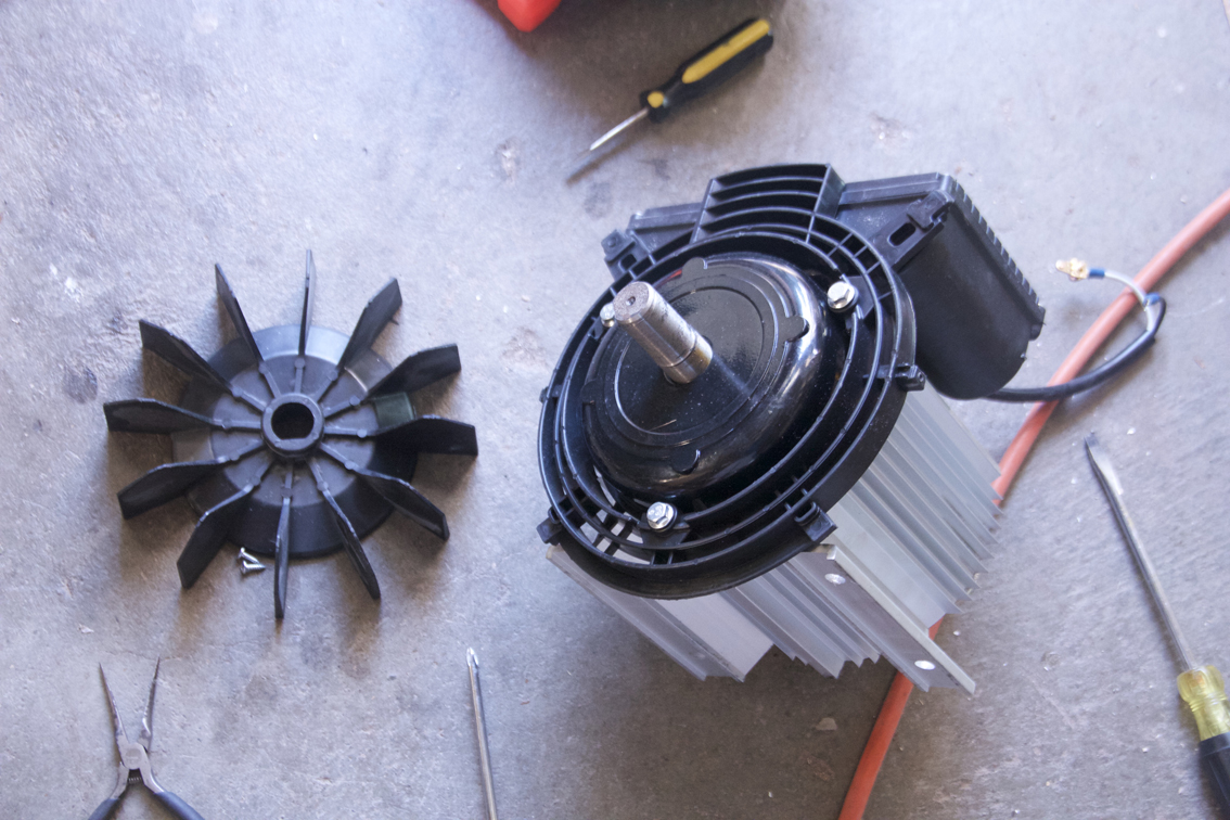

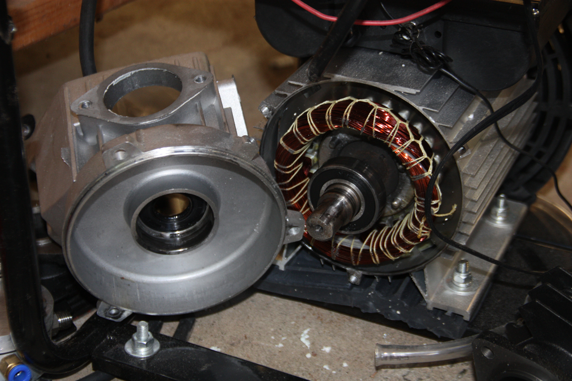

The other info I have for you is I have separated the motor and crankcase of Guy’s oil burner Airmax. One of my web clients is one of the big local electrical shops, so next week I’ll take the motor down and have them take a look at re-wiring it to 220vac. If we could change our motors over, it would make the Airmax so much more useable!
Fellow Airmax owner Ray had an idea about using the armature of the original factory motor as merely a driveshaft (motor unpowered) and attach a pulley to the fan end of the shaft. I am excited to see that it is a robust shaft at the fan end. One could easily fabricate a split clamp pulley and mount the factory motor on a plate with a 1/2 size electric motor driving through a gear reduction pulley and belt. A small enough motor geared to operate at under 15 amps would be great, ’cause then we’re talking an inexpensive generator for remote opps and hotel room outlets for less than remote but on the road re-fills. If I have to give up 40% fill time geared down it’s still plenty fast for me.
