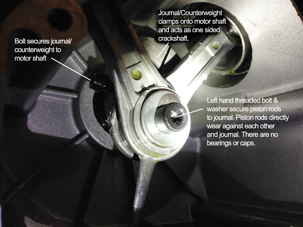

The crankcase needs to be drained of oil and the crankcase cover & gasket membrane removed. The motor shaft extends into the crankcase a short distance. Onto the motor shaft, the counterweight / journal is clamped. The piston rods hook onto the journal and are secured by a single, left hand threaded bolt. Removing the bolt is easily accomplished by stopping rotation of the counterweight/journal with a small block of wood placed inside the crankcase.

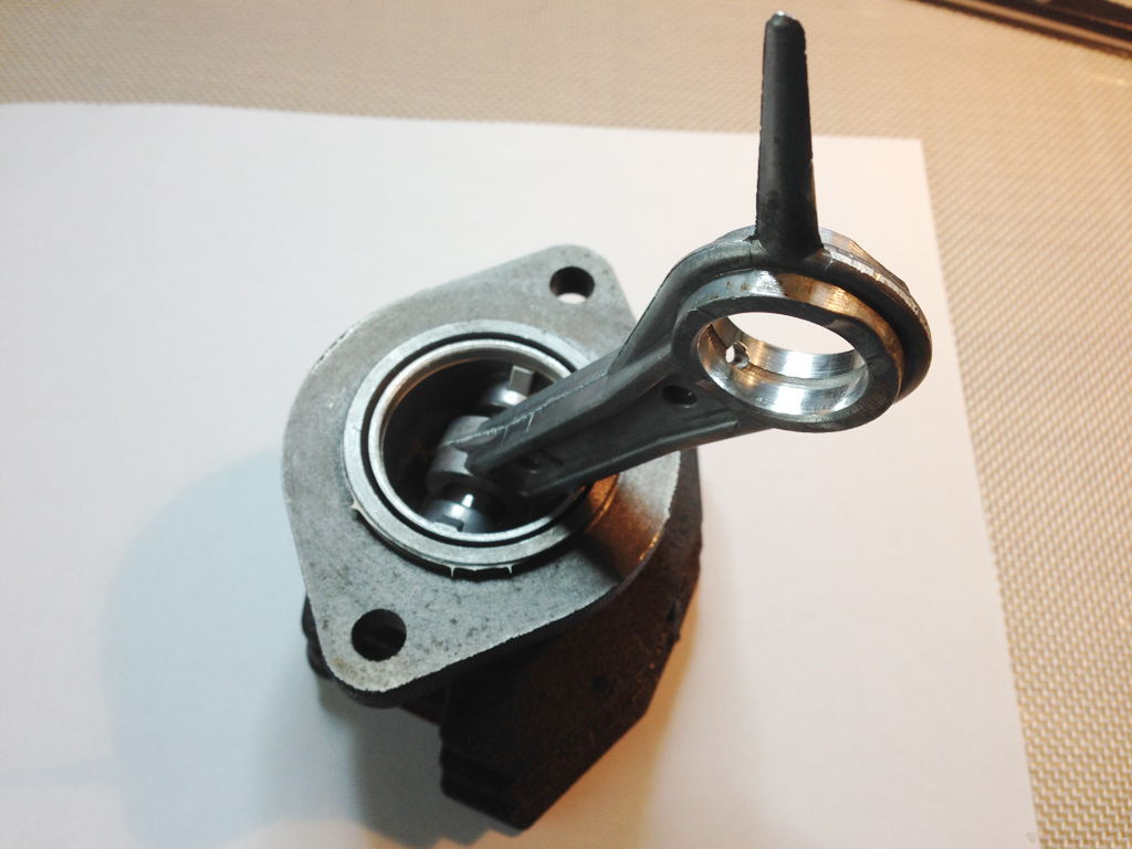

Here is the low pressure assembly removed.
While everything was out, it was easier to examine the parts and get better pictures.

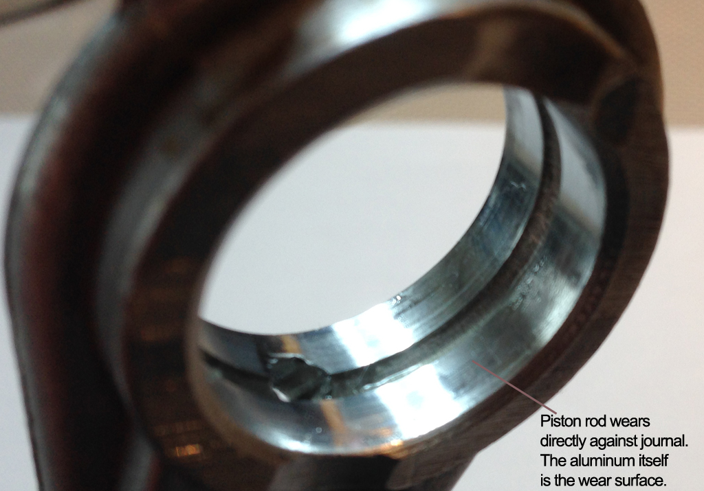

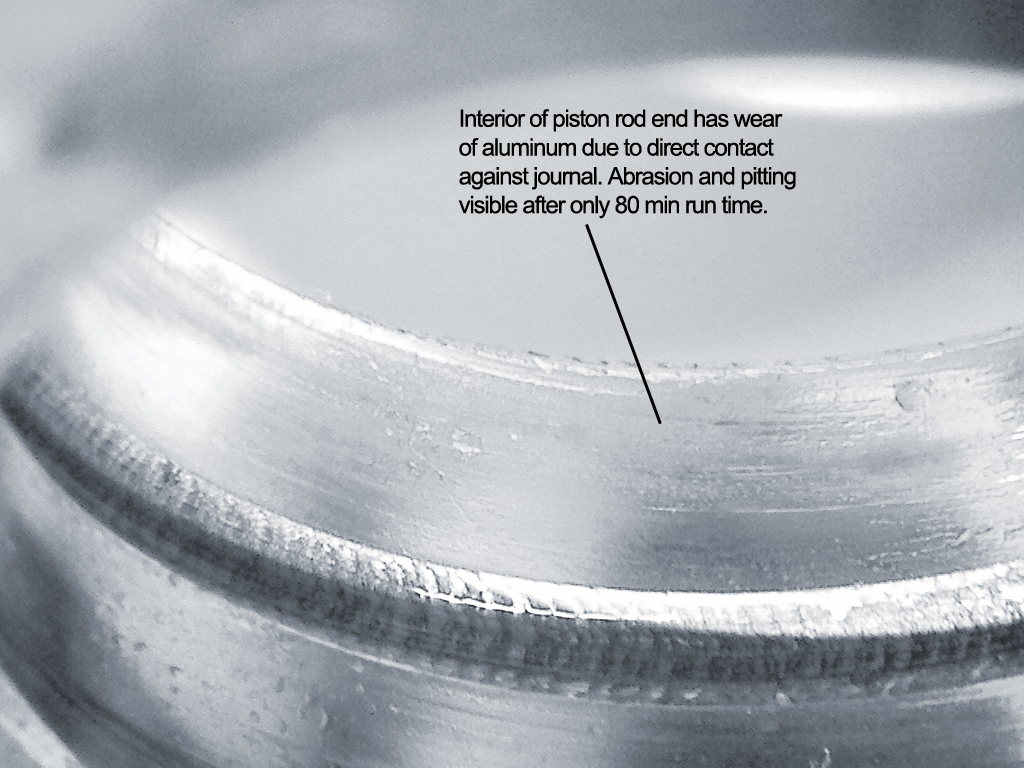

There are no hardened bearings protecting the piston rods. The piston rod aluminum itself is the wear surface for both ends of the piston rods. Even with just 80 minutes of run time, wear and pitting is evident inside the piston rod “bearings”
Here is a closer view showing the wear and pitting. I was wondering why the crankcase oil was so black. Blowback carbon from the high pressure cylinder was one thought, but after seeing this, I suspect a fair amount of the darkness is actually worn aluminum. Those scrapes and pits in the below picture are not residual oil. That is what the bare aluminum looks like inside the wear area.

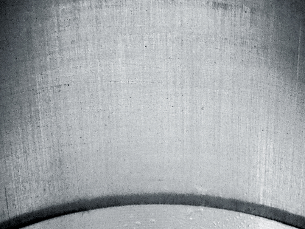

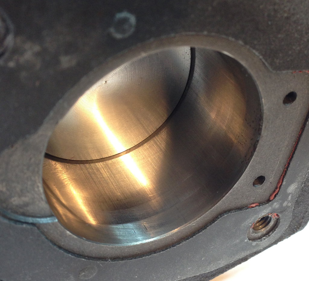

With just the right lighting angle, there are some faint lines that might be fine honing. They are at an extremely shallow angle and are visible at the very top of the cylinder.
The main cylinder walls show the lines from the rings moving up and down.
So, back to the opinion of the master mechanic after he took apart and examined the assembly. He thought the ring gaps were actually OK and not enough to be the reason for the oil consumption problem. Also, he found the cylinder smoothly polished. The degree of honing was also thought not the culprit for my problems. If any honing was done, it would need to be very fine.
