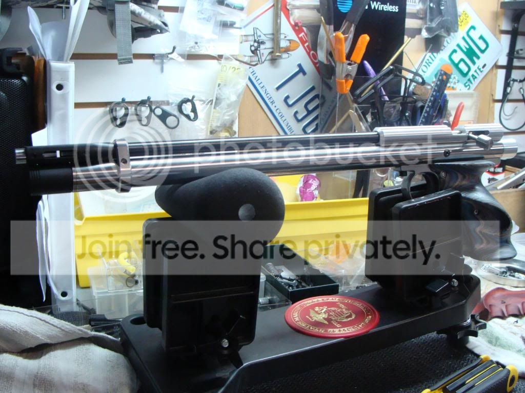

Joe,
That is a beautiful gun!

Nice gun and nice work.
