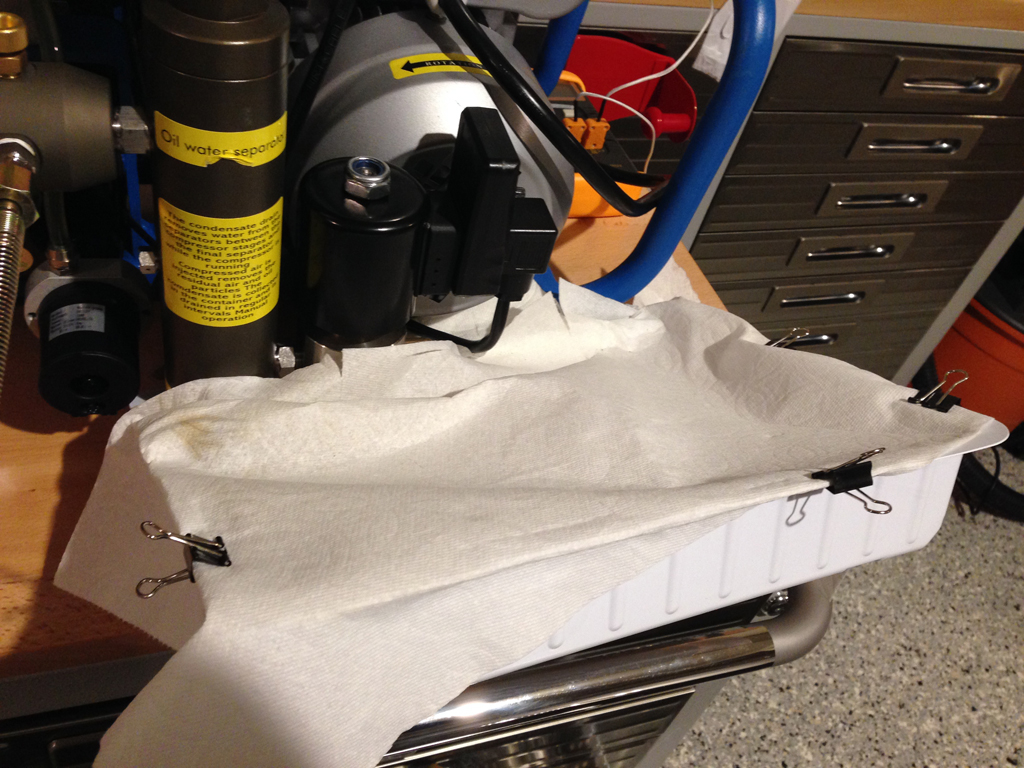

Compressor was run 24 hours non-stop to examine how it fares under prolonged operation. This is roughly the equivalent of two years of topping up a Great White once a month. I used the PMV as the test load because it was not practical to repeatedly empty and fill a tank continuously. The PMV at 2500 PSI provided a substantial load that could be sustained for the entire run. The compressor remained cool and NEVER stopped during the entire 24 hour run.
Auto drain was set for every 10 minutes, 1/2 second opening
Tray was set up to trap condensate. We already know this demonstrator puts out some oil. I don’t want that getting all through the garage and we want to examine how much oil is being blown by. (Sincere says the production units should have 1/3 oil blow by of this unit)
Output of the compressor was wrapped to go through multiple layers of paper towel to act as a “tell tale” for how much water and oil were getting past the separator. After an entire 24 hour run, we should be able to tell if excessive amount is getting through.

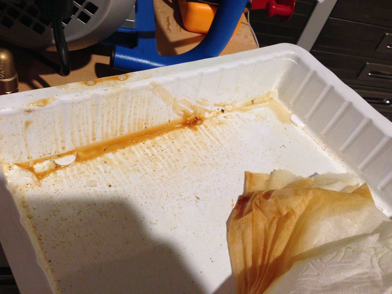

How much oil came through the system? The is my catchment tray after 24 hours operation.
Some oil clearly gets by. It’s not a huge amount. The oil is darkened, but not black/dieseled. Air in the garage has the scent of Bauer synthetic oil. No fog bank effect was seen filing the air.
Mind you, this is 24 HOURS of continuous operation producing this much condensate output. Water was mainly gone, but you can see the film of oil. If the production units can get this down to 1/3, I’d be very happy.

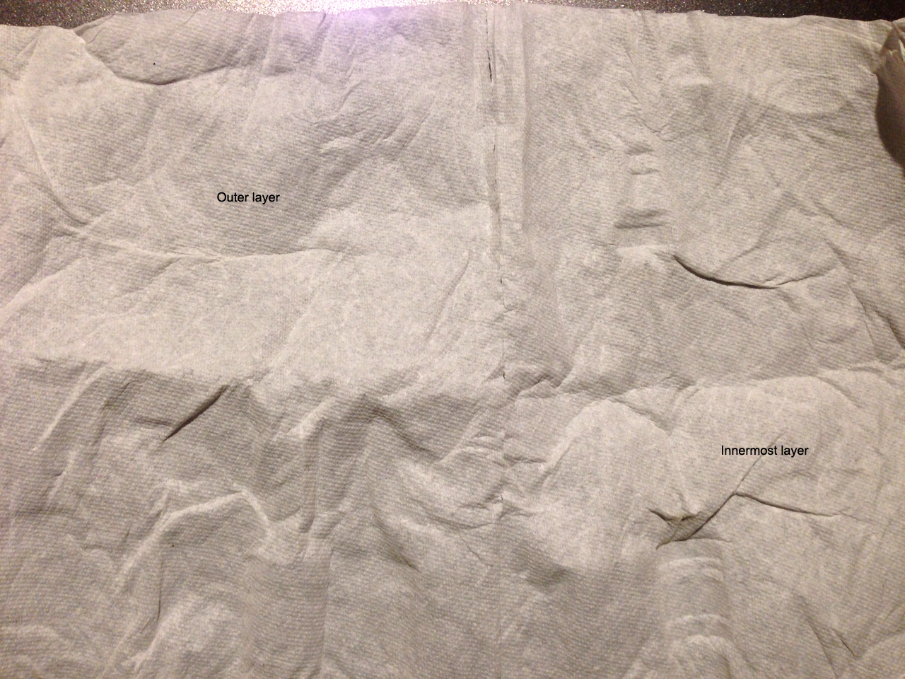

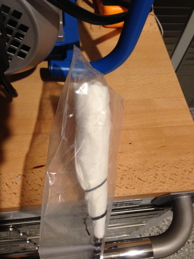

More importantly, how much water & oil are getting past the separator? Uwrapping my tell tale revealed…
I had expected to see very noticeable accumulation. After a whole 24 hours, some moisture and oil spotting has just got to be there I thought. At first I could nothing. Only after fully unrolling and comparing the outermost and innermost layers could I see a difference. Just a little oil gets past the water oil separator. A filter with molecular sieved dryer followed by activated carbon will easily handle this for multiple tank fills.
24 hours continuous operation endurance and degree of separator efficiency impresses me. I expected the separator would be good based on the low air temperature, large separator size, and PMV, but this degree of separation was better than I could have imagined.

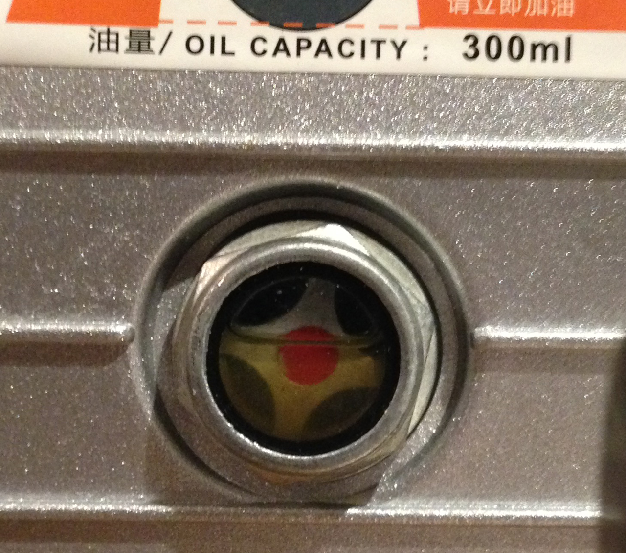

Compressor arrived (thankfully) without oil or coolant. You really don’t want oil in the machine during shipment. The coolant is shown as antifreeze on the youtube video, but I was told water. I’ve filled with water since that has a higher heat carrying capacity than antifreeze.
I used Bauer synthetic compressor oil. The crankcase label indicates 300 ml and that is about what I poured. Oil level is easy to see as one fills the crank case. They’ve made the label and observation dot indicator very easy to understand. Just fill to the top of the red dot and no further.
