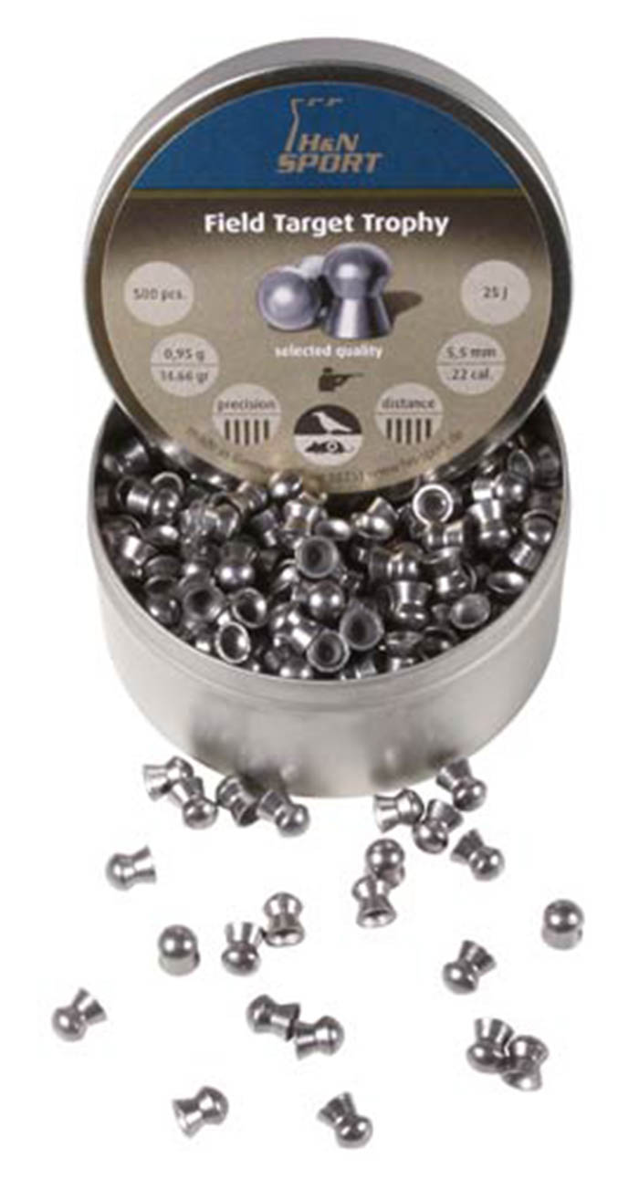

This “H&N Field Target Trophy .22 Cal, 14.66 Grains, Round Nose” is a little light for Lelya, but it could work well Lelya. JSB 16 grain head size is 5.52mm, this H&N head size is 5.53mm. The H&N pellet seem to work great @ high velocity, not sure if anyone test it before.

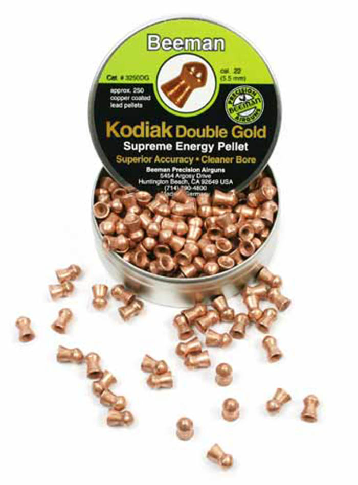

I have some spare “Beeman Kodiak Double Gold .22 Cal, 21.14 Grains, Round Nose”, I will try these to see how it goes, it’s too heavy for Lelya, I know, but I just want to try it out, who’s know it may perform good on Lelya ๐Ÿ˜† ๐Ÿ˜† ๐Ÿ˜†
