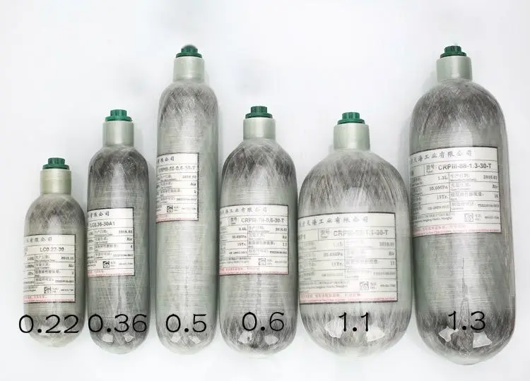

It depends what your are filling with the 500cc backpack bottle, I get 70 shot on the reg from my .22 Matdor std and 90 shots on the reg from my .25cal Matador Long both of which I can get one full top up from 120bar to 245bar and a couple more at around 200 and 180 bar. That’s a lot of shots in the field for me.
Now if we are talking a smaller PCP such as the Leshiy it fills it many times over and again is more than enough for a good day out.
If you want to shoot lots of lead or have a air hungry toy I recommend the 2 litre 300bar bottle.
https://www.aliexpress.com/item/AAA-Quality-High-Pressure-2L-Cylinder-Compressed-Air-Cylinder-Oxygen-Medical-Tank-Cylinder-PCP-Paintball-Tank/32698229709.html?spm=2114.13010208.99999999.292.S86Y6b
the same valve I posted in the link previously fits this too. its bigger to carry in a backpack but 4 x the capacity of the 500cc and still very light.
Still want more? go the 3 litre.
