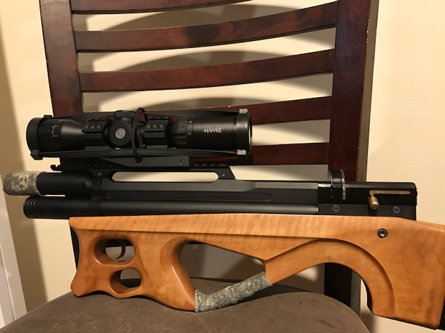

OMG My New Lelya 20 cal ….
:8: …. BEAUTIFUL it’s wood (dark and highly figured/curly), thank you very much Tony !
I’ll see how it shoots .. if it shoots … as good as it looks … when the scope and tons of 20 cal ammo comes in soon.
Thanks for the l@@k see ……… and more info to come !
~ Greg
