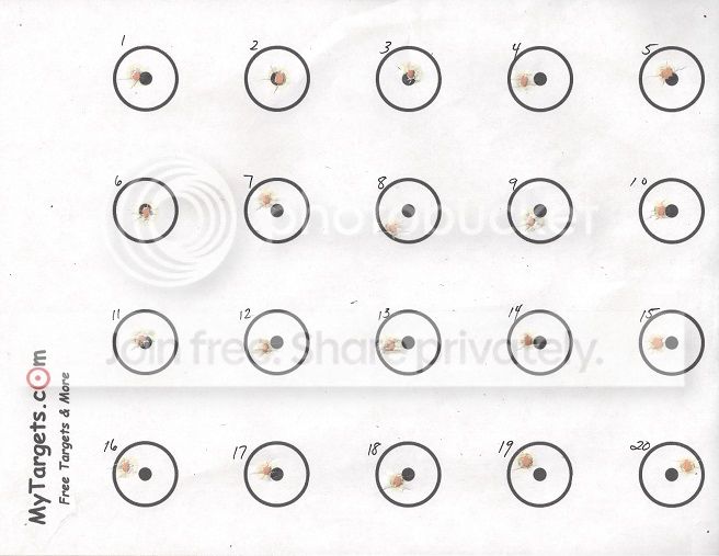

[/url][/img]
This is a bad example of how well this gun shoots.
20 shots and 20 yards. Gun on bipod on uneven dirt and grass. WokButt balanced on back hand while I was kneeling down shooting, along with underpowered scope.
70 fps spread isn’t too much. Like I said, I’m usually good with 50fps spread with my marauders.
Also, you just bought a chrony and barely know what you’re doing…how is it that you are saying what is too much of a spread and what isn’t on a bell curve.
As far as tuning and adjusting…you sort of slammed Tony’s tophat, but you haven’t used one. The inserts are how you tune the tophat. If you think adjusting airflow is not tuning, I don’t know what to tell you. There are other ways you tune the gun other than adjusting the stock tophat. Your opinions are misleading to people who think you might actually know what you are talking about.
It’s perfectly fine to be wrong, but to spout opinions without really knowing the full subject matter is dumb.
Also, if you know where you gun shoots, a 200 fps curve is useable. Knowing your gun and its shooting points is key. Just like zeroing your scope at say 30 yards. You have to know the aimpoints on your scope when you shoot at something at other distances. It’s not like you just adjust the distance on your scope and hit a bullseye by putting the crosshairs on the target at 50 yards. Depending on the curve of your pellets trajectory, you will have to aim higher or lower…usually done by using the mildots. Other times people just know where to put the crosshairs so the pellet goes where they want it at different distances. So fps spread is really only a component of what the user/tuner wants it to be. If you want consistent, same speed/energy shots you keep the fps spread small.
Othertimes peole don’t even want a spread. They want 5 or 10 full power shots that start high and decline as they shoot.
All sorts of different types of tunes. All sorts of ways to get there too.

As for the bell curve of 70fps difference for Woody’s condor, I believe that’s too much! I don’t know exactly how much POI change is, so if you know please tell us.
About the width of a tic tac.
